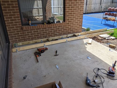

I have an alfresco area which I'd like to deck.  The joists (Green lines) will most probably fix straight into the concrete and ideally, I'd like to go 1500mm beyond the concrete (Red line).  I have a storm water pipe (White line) about 800mm out from the concrete.  800mm out from the concrete, the ground is at its lowest point, which is about 200mm lower than the alfresco.  With regards to the footings and bearers, what are my options?

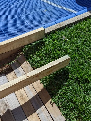

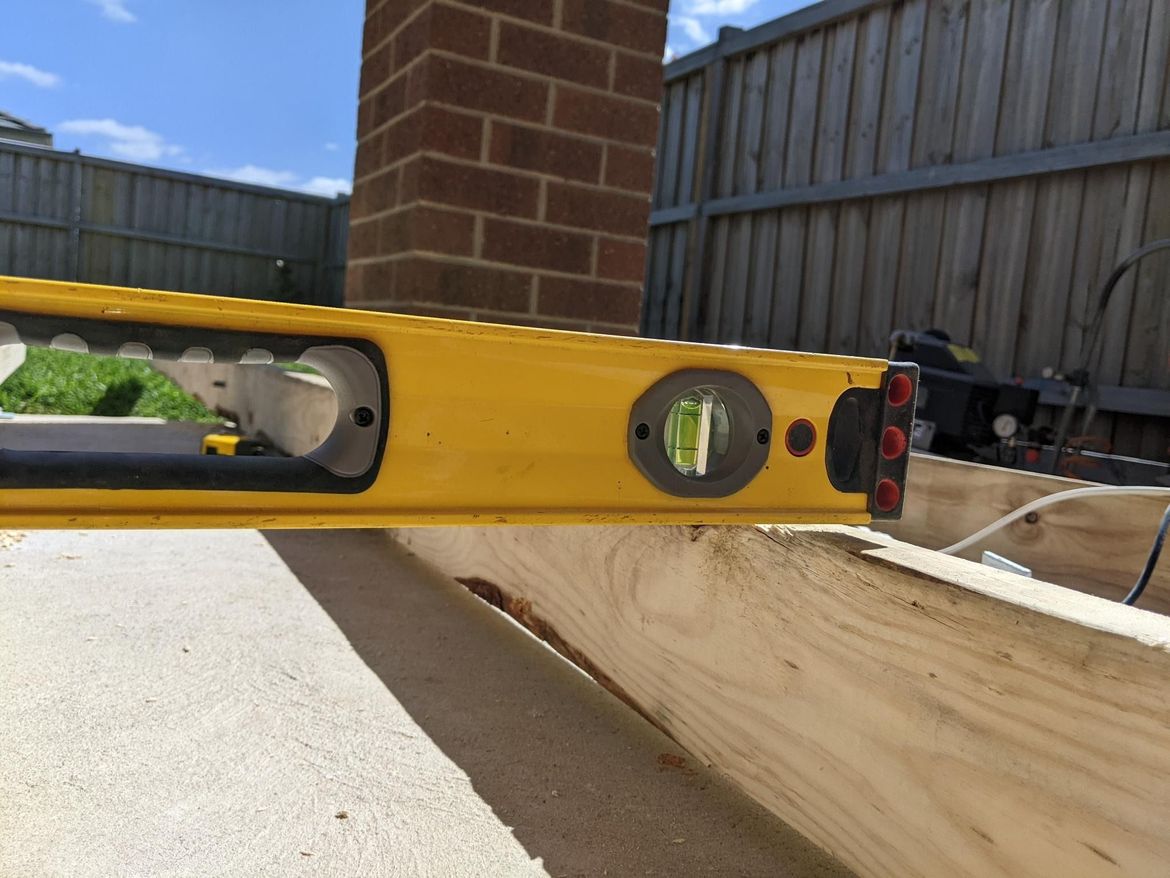

The first 2 joists (green lines) are what I started with.  I've been working off the GREY line as my initial height, then making the joist level by fixing it at the appropriate height on the last bracket (YELLOW line).  Along the lengths of the joists, they're level and at worst, maybe 1 or 2mm off.  However, I'm finding some joists are not level with their neighbor and might be up to 5mm low in some spots.
Generally, most of the joists and their neighbour are pretty even and I figure a variation of 1 or 2mm won't be noticeable.  I'm less concerned about the level along the lengths of the joists (as long as all the joists are the same), and interested to know how best to handle levelling the joists with their neighbor since that's the one that'll give me wonky results when the boards go down.
The first 2 joists (GREEN line) some how have managed to be 10mm higher, so I'm going to undo bolts 2, 3 and 4, drop it down, check the levels and redrill/elongate the holes which should sort that one out.

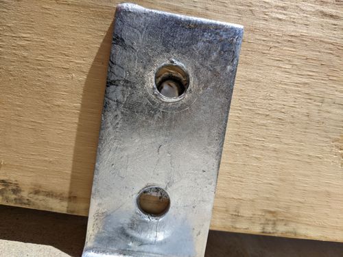

For the first 2 joists, it looks like only joist 2 was a little higher, so I've undone the bolts on joist 2, pushed it down until it was level.  You can see the difference in the hole:
With the bolt removed, the joist wants to drop rather than flex up (assuming there is warping), redrilling the hole won't introduce any loss of strength to hold the joist at the right level.  Now, I can run my level across joists 1,2,3,4 and 5 and we're level again.  Only joist 3 so far it's still a few mm lower, but I'll just remove it, flip it around so I have fresh timber to drill holes into and re-fix it at the correct level.  If I can eliminate those big 5mm variations (which there are only 1 or 2), the rest I can use a plane to shave a mm here or there. I don't think 1 or 2mm across the deck would be noticeable anyway.

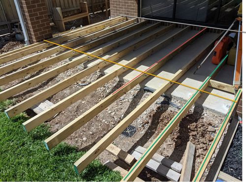

So far, so good.  I have to remove 2 joists at a time since the 12mm auger PLUS drill won't fit into the 400mm gap between the joists.  However, that also allows me to double check and adjust the joist regardless.  Either way, the tops of the joists are about as level as I would expect.  Once I've fixed them all, I can run a string line over them to see if anything needs tweaking with a shim or plane.
