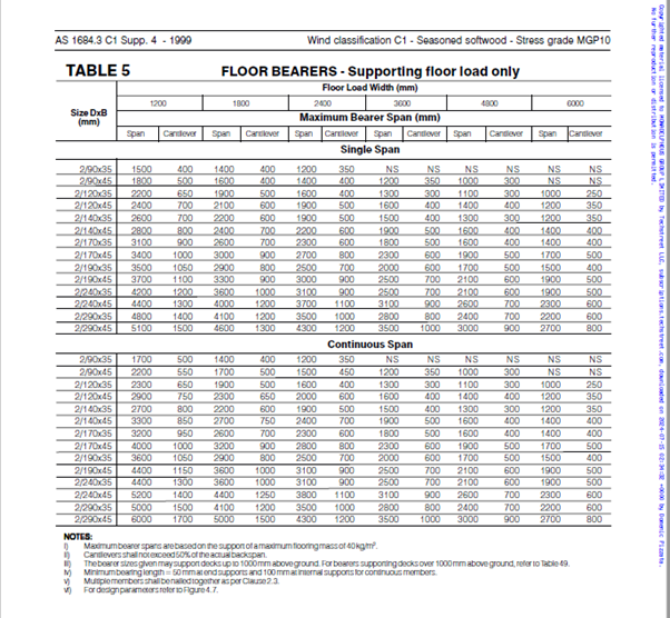

Looking through the AS 1684.3 for building a ground level deck.
All the bearers listed in Table 5 Floor bearers, Supporting floor loads only. Table five was recommended in one of the many deck building design guides I have read.
There using two boards bolted together for all bearers. There is no option for single boards at a larger size to manage the load.
looking at YouTube videos where professionals are installing ground level decks.  They all seem to use only one board as a bearer.
So I can get a cantilever at one end, from table 5, I need two 190mm x 45 timbers bolted together.
I picked this size as to get a 900 mm cantilever and a 3 metre spacing.
Is this correct or am I missing something here by having to bolt two boards together.

While I don't have direct access to AS 1684.3, I understand your concern about needing two 190 x 45mm timbers bolted together for the cantilever. A cantilever of 900mm is indeed quite large, and it's not surprising that the design guide would specify two laminated timbers to achieve the necessary strength and stability. Using two boards bolted together can be an option to achieve a span without resorting to a single, much larger timber.

The AS tables suggest two bearers bolted together even if I wasn't  incorporating a cantilever.

I can only suggest what the AS table recommends. I propose engaging the services of an engineer or builder and presenting to them your idea of using a single beam in your decking plans.
