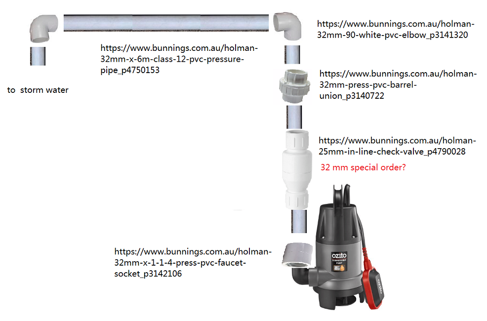

I am still planning this project and I have further queries:
 Please confirm I have specified  the correct parts and advise if any part missing? In particular is the check valve a special order.  Are all fittings require a socket.
For the pit riser can I drill 32mm holes in the wall anywhere?  In particular how far from the top?

Re: Cutoff Drain Sump pump Pit
Hello @kn_ll
In order to avoid a bottle neck in the check valve, I suggest reducing the entire run to 25mm. This will make it easier to join the parts together and you won't have to special order a 32mm check valve.

I would like to stay with 32mm as it less strain on the pump motor therefore increasing it life.  Do Bunnings have a 32mm check valve?

Hi @kn_ll
I'll have to double check if the check valve comes in 32mm. However, as another option you could use a 40mm check valve and use reducers at the ends so that they fit 32mm pipes. As soon as I have more information, I'll let you know.

Hello @kn_ll
I've just been in contact with our provider and they have informed me that they don't have a 32mm PVC In-Line Spring Check Valve. There is the 25mm and then the 40mm. I'm going to stay with my original recommendation of using a 40mm check valve instead of a 25mm so that you don't get a bottle neck in the flow of water.
