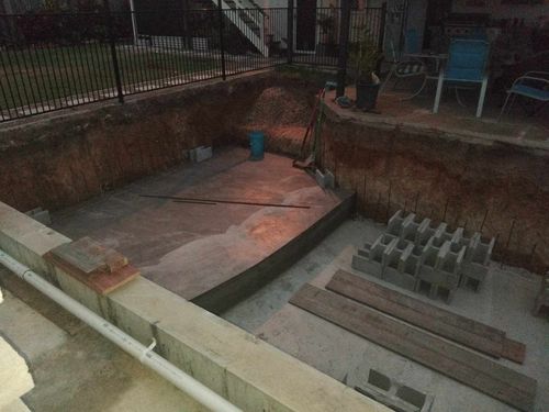

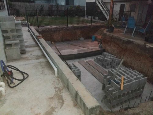

Hi DIY community,
It is time to repaint my concrete swimming pool. I did it 10 yrs ago but it needs redoing. I don't recall exactly the paint or other products I used last time but essentially followed these steps::
1. Empty water (nearly done - see photos!).
2. pressure clean surfaces.
3. Acid cleaned surfaces (??- would TSP solution (or Bunnings tricleanium) do similar job?)
4. Paint (??-any suggestions on best paint to use?)
Any tips/advice on best way to proceed would be welcome.

Hi Mitchell; can I please ask for advices on how or what products to use to hydroinsulate the concrete pool. We are building DIY pool - concrete slab and besser blocks walls .
What pain/ hydroinsulation we should use and do you have advice for suppliers.
Also do we need to use rendering on besser block or just straight on besser block wall apply hydroinsulation?

Welcome to the Bunnings Workshop community @MikaB27. It's terrific to have you join us, and many thanks for your question about building a pool.
As Bunnings and our suppliers don’t stock these specialised products used for waterproofing or painting concrete pools, I’m unfamiliar with the application process or which specific systems would best suit your build. From what I understand, concrete pools often require a specialised waterproofing membrane—sometimes a two-part epoxy or cement-based product—followed by a compatible pool-grade paint or surface coating. These are quite different from typical exterior waterproofing products.
In terms of surface prep, I believe many systems recommend rendering besser block walls first to create a smooth, uniform surface for waterproofing, but it may depend on the specific product you use. I’d recommend speaking with a pool builder or a supplier that specialises in pool construction materials to get the right advice for your setup.
