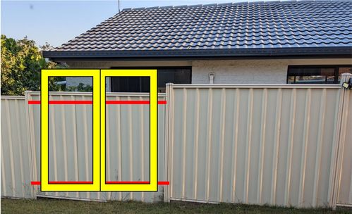

I came across the Colorbond fence extensions (https://www.bunnings.com.au/colorbond-steel-340mm-domain-fencing-post-extension_p0910756) on the Bunnings website, but I think it wouldn't be as straightforward to install as the panels I want to extend are stepped (on a sloping ground). Anyway, here's an image of what I'm planning to do:
Did some measurements and realised that I can probably get away with 1.8m tall lattices, as I'll still have about 30cm worth of lattice protruding from the top. The red lines are the 2 pieces of timber I'll screw into the posts. I'll put 2 of the lattices (in yellow) side by side to span the whole Colorbond panel, and probably do the same for the panel to the right of it. I have 3 more questions:
1) How many places should I secure the lattice to the timber? Would 4 corners be sufficient or should I do as many as possible?
2) From an aesthetics point of view, would it look better if I have my lattice follow the stepped fence, or just have it level the across the 2 panels I'm planning to have the lattice attached to?
3) Do you have any tips on making sure the timber is level as I attach it to the posts? I always have issues drilling holes and attaching things together and having them level. A hose reel I mounted on my brick wall is slightly askew because of this... Thanks!

I suggest a minimum of four screws per timber piece, one screw every 400mm. However, if you wish to put more screws on, you can reduce the distance to 200mm per screw. From an aesthetic point of view in my opinion it would look better if you followed the stepped fence, it will give your fence a unified look. My only recommendation to keep the timber nice and straight is to use a spirit level. Once you have it in place mark its position with a pencil and do pilot holes at the end of the timber piece so that you can mark the fence where you need to drill.
It will be tedious and will take some time, but it will guarantee that your timber installation will be nice and straight. I can understand that it feels like it is taking too long and you are not making progress. Don't give in to the temptation of just winging it and going faster, the final results will speak for themselves.

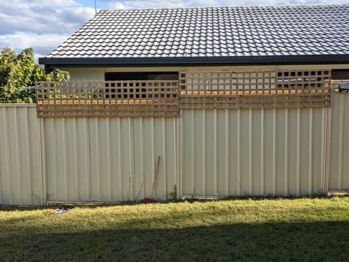

Just thought I would post an update with the finished project.
I used this H3 42 x 18mm timber across the posts as it was cheaper and I thought the colour was a bit closer to the colour of the fence and would help hide them a bit. I also just used a single 2.4m by 0.6m timber lattice horizontally to extend the height of the fence. The lattice was attached to 2 horizontal pieces of timber, one at the bottom and one about mid-way up, with one screw every 20cm or so along the whole lattice - hopefully that's enough to support it. We might add some artificial hedge tiles to the lattice to get even more privacy.
Thankfully everything looks just about level. Had some issues with the metal screws to attach the timber to the colorbond posts... some screws tended to wander around a bit before cutting into the post. Is there anything I should be doing to avoid this in the future?

Looks excellent, @unawarek! Well done.
To stop your self-drilling screws from wandering, you can mark the locations where you want the screw with a centre punch. Just give it a slight tap with a hammer, and it will leave an indent in the steel. Your screw will then self-centre in the dent and not wander.
