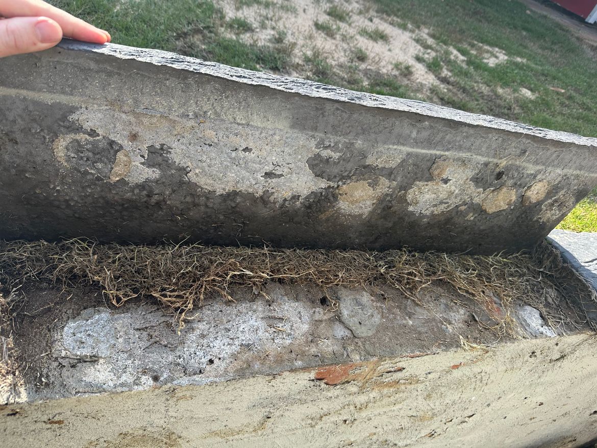

Thanks @Dave-1 and @EricL. Here's a pic.
I think your questions have helped answer mine. Not sure what it looked like before the coping stones were originally attached, but I think it was bare bricks - you can see some of the bare brick in some spots. The brickwork now is not a clean and level surface, though. What would be the best way to go about cleaning this up and prepping before trying to attach them again?
Morning @ludicrousgib
hahahah yeah the lawn is reclaiming the concrete ![]()
I would pressure wash the lot (top and bottom), you will have paint flakes peeling off the bessablocks for sure so make sur enothing you like is around. I used a sheet drapped over a frame to stop the paint flakes from going further. Hit with a wire brush for anything else that is holding on. Then mortar it back inplace (the whole row of capping stones would potentially be an idea. If you are only replacing some then id measure the difference of the cleaned height against its neighbour to see what type of mortar you want. Id rather mortar over liquid nails asI feel it may be more forgiving.
It's great to see that @Dave-1 has already provided some advice @ludicrousgib. I'd suggest scraping off the roots, scrubbing down the area to remove debris and then glueing it back on with Landscape Liquid Nails. If mortar had been used before, it certainly wasn't very thick. Adding mortar without removing the old will place this tile higher than the rest. Running a few beads of Liquid nails will hold it in place and won't change the height much.
