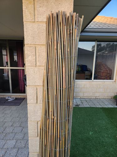

"My best advice is to drill pilot holes in the bamboo to prevent splitting them"
From what you said above, would it apply to this photo attached?
Im assuming that was for bigger bamboo slats? 
Re: How to attach bamboo screen to Colorbond fence?
Hi @kelso101,
The pilot holes would be for the larger bamboo. You can pull the bamboo screen tight and screw between the bamboo pieces to fix it to the batten. I recommend using Zenith 8G x 20mm Galvanised Button Head Stitching Timber Screws, as the 30mm @EricL mentioned might be too long for the smaller bamboo. Staple nails could also be used.

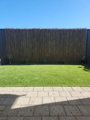

 thanks Mitchell and Eric for the assistance. Managed to put it up. The batons was a little tricky with the tek screws but all good.
