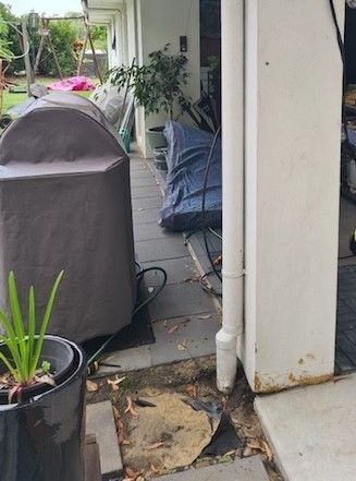

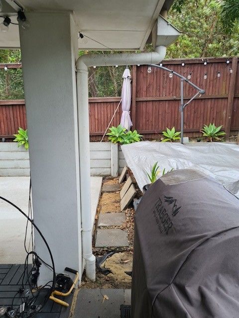

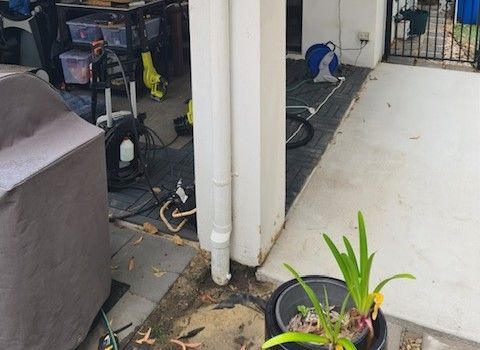

Re: How to add patio drainage?
Hi Jason,
Extra pics of the area in question:

Hi @Sched7,
Looking at your pictures, I think you're right in the idea of using a grille type drain, there are a few types of these around,

Hi @Sched7,
No worries with the advice, but I think you've got the absolute right idea there, with that large collector below the downpipe.
For two reasons, firstly, I have no idea why there is a collector up under your existing spouting, unless there is more than one set of spouting feeding into it, otherwise it is a complete waste of time and money.
Secondly, the collector should have been installed at the base of the down-pipe originally, the reason you have a collector, is so that the down-pipe
does not air-lock and flood the pipe during heavy rainfall, it needs to be able to vent to atmosphere.
The way you've shown in your last diagram will be perfect and will also allow you to clean any leaves and whatever may block things up.
Top marks, mate, I'd like to see this when it's finished.

Cheers Mike. Interesting point re the collector location - out of the 9 downpipes around the house, 2 have the collector box at the top. The one in the pic is indeed being fed from 2 gutters however the other one isn’t, so not sure the reasoning for installing it that way.
Hopefully by the end of w/e I’ll have a better idea of which solution I’ll eventually end up going with once I’ve done a bit of digging - will post pics.
