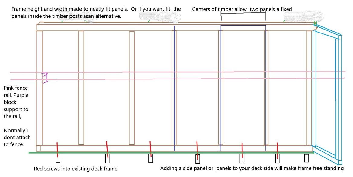

The frame  idea  screwed to the frame under the deck will be solid  I would like to see the top held some how.  Maybe spacer blocks to the fence.
Or a  corner return with an extra a panel will make structure  free standing. As I dont like attaching to fence as one day fence will need service.

@Jewelleryrescue touches on a very important point and that is the stability of the timber frame you'll be attaching to your deck. Even though the Matrix panel has holes in it there is enough of a solid surface that it acts like a solid wall. When storm rated winds hits this frame it might not be strong enough to withstand it.
I propose mounting the matrix panels on the Colorbond fence instead. You'll need less material and you still get the extension you're after.
My best advice is to draw your mounting plan on paper first so that you'll know where to position the timber frame and the panels. This will save you from having to second guess the arrangement of the panels.

@EricL just a bit confused, you mentioned to mount the matrix panel directly on the colourbond fence. Why do we need a timbre frame then?
So is my idea going to work as per the photo I attached before where I run a horizontal timbre piece at the bottom of the fence screwed to the deck joists. The top one will run against the fence but the fence has a slope so some sections will be screwed to the highest point of the fence and the rest of the piece will be hung and supported by one vertical timbre where it's connected to the fence.

My apologies, I should have clarified that the timber I'm referring to is the one going between the posts of the Colorbond. Technically just a piece of timber and not actually a frame. But because there is one at the bottom and one at the top, hence, I refer to it as a frame, but I will just refer to it as timber mounts from now on. Sorry for the confusion.
On closer inspection it's only now that I noticed that your deck is right next to your fence. In regards to your question, yes, it will work. Please note that any panel that goes past your deck will need support at the bottom as well.
I suggest using Zenith 10G x 50mm Galvanised Self Embedding Head Metal Screws Winged to screw the timber into the Colorbond post. I recommend using Zenith 8 - 10 x 100mm Treated Pine Countersunk Head Screws when attaching the timber to the deck.
