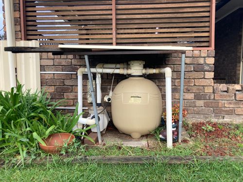

I am looking to put some protection around my pool pump. So that the equipment can be accessed, I am thinking to only have two sides on it and then a roof that can be opened.
What would be the best material to build this from?
I’ve attached a photo of said pool equipment (with its current very flimsy cover). It’s right up against a brick wall so the cover could be attached to the brick.

I'm a massive fan of the Specrite slatted and fence panels. They would make an excellent choice of material to use as they are rigid and quite good value. They would also complement the slatted screen behind the pump. With a couple of posts concreted into the ground at the front, you'd have something to build off, and you can use the wall as the rear mounting point.
Let me know what you think of the panels, and if you're happy with using those, I can come up with a method for constructing the walls and roof.

Thanks @MitchellMc, I like the look of the fence panels as they’ll match the panelling on the bbq area above the pool pump. However, I don’t think the dimensions work. I’ve taken measurements and my fencing (noting I only want to fence 2 of 3 sides) would need one panel that is 1m wide x at least 90cm tall and another panel that is 80cm wide x at least 90cm tall. Can I do the fence panels myself rather than buying pre built?

Thanks @MitchellMc! The screening looks like a good alternative, I’m happy to put in the work for something that’s going to last a long time! What material would you recommend for the roof? Ideally I’d like to attach the roof to the brick work behind the pump

Did you want the roof to be weatherproof @kflynn89? If not, I recommend once again the Specrite slatted panel. Turned sideways and cut down to fit the depth, it would be perfect for attaching to the wall with hinges. Alternatively, you could create a frame out of H3 treated Pine and affix the roof sheeting of your choice.

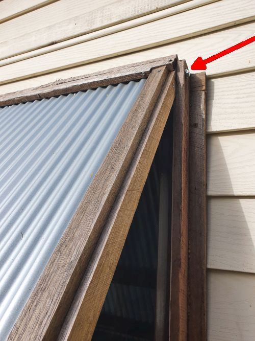

Just a Sunday morning suggestion. I love mini-corrugated iron. I used it with wood from pallets to create a sort of window awning. It's a pre-made frame that attaches to the the wall. The iron is hinged by two bolts at the top. Maybe something similar for your pool cover?
Cheers.

Thanks @Noyade, I like the idea and might use colourbond sheeting to match the colour of our fencing.

Thanks @MitchellMc! it needs to be weatherproof so I think I’ll frame up some colourbond sheeting to match our fencing.
For the panelling I’m thinking lattice makers and I can cut into one 1000 x 900 piece for the front panel and one 800 x 900 piece for the side panel.
