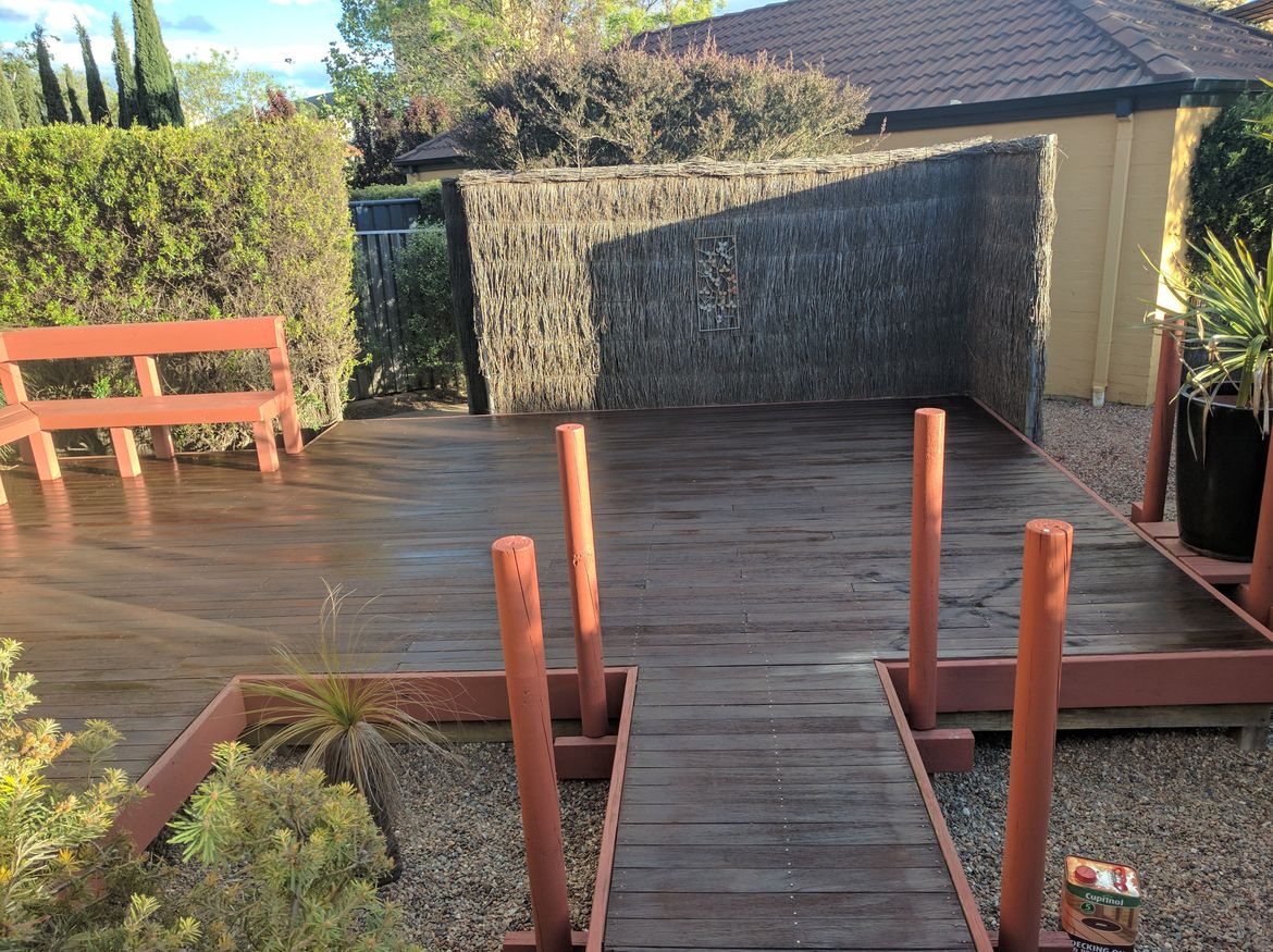

How much linear meter decking do I need to order for replacing whole deck of 38m2?

- Calculate your area first. If you have areas that are not part of the main deck, I suggest calculating them separately. For example: If you have a decking area of 7(L) x 5.43(W) = 38m2 (decking area).
- You'll need to divide your decking area by the width of the decking boards. For example: If you are using 90 x 19 it would be represented as 0.090 you then add your gap of 3mm which brings it to 0.093. So 38m2 divided by 0.093 = 408.60 rounded up would be 409 LM.
- Ideally, you would add 10 percent for timber wastage. 409 LM x 1.1 = 449.9 rounded up would be 450 LM.
