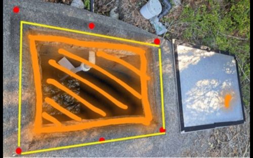

I replaced the heavy concrete lid on my in-ground water tank with a metal plate.
It is screwed down into wall plugs in holes drilled in the concrete top.
After numerous times unscrewing to check water levels, I want to add hinges and latches to make access easier.
Since the top of the concrete water tank is curved like a dome, the metal plate edges don’t contact concrete near the edge when it’s not screwed down. (See yellow lines on the photo)
With 3 hinges on one side and 3 latches on the other side placed near the screw holes, the latches would need to pull the metal lid down like the screws.

The existing seal is a 3mm felt strip but I might use a thicker foam or D shape weather strip.
The biggest gap is on the corner closest to the concrete top edge.
Thicker foam or D shape strips would compress so latching does not need as much pressure to bend the metal plate to mate with the dome concrete top.
But then I need to address the additional height difference between the metal lid and the concrete which will depend on how much compression of the D shape weather strip.
The adjustable toggle latch will allow easy adjustment so I’ll probably put these on the side of the metal plate closest to the edge of the concrete top.
The metal lid is about 3mm thick.

Hello @Steve5 just curious as to why you are not using the existing recessed framing?
A smaller piece of chequerplate edged with a seal (of your preference) with 2 handles attached could be placed/removed easily as required, in a similar fashion to the previous concrete cover/hatch, no latch, no hinges just pure interference fit and gravity 🤔
Re: How do you add hinges and latches to a metal lid on a concrete water tank?
Good idea, wish the tank cleaning company that made the metal lid had thought of it..
