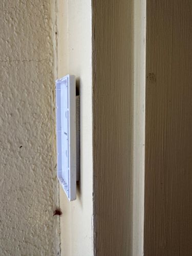

I'm planning to change my existing door bell
to one with security camera.

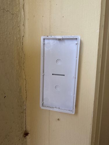

When I try to remove the old one, I am unable to figure out how to remove it as I cannot see any screws over the back plate. It seems to stick quite hardly on the wooden door frame.
Is it supposedly to be glued only, so I should try to just remove by force? Or any tips or tricks to remove it?
Thanks!
Hi @sisimon510,
Many thanks for your question.
It looks like it has been stuck on mounting tape such as this Scotch-Mount Extreme Double-Sided Mounting Tape.
They can be surprisingly sticky, so it may seem like you are going to break something, but forcefully removing the plate is the way to do it.
A small flathead screwdriver should be adequate to lever the plate off.
Let me know if you require any further assistance.
