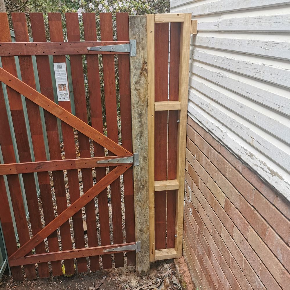

Although Hebel blocks can have light to medium-weight items attached to them, I wouldn't recommend attaching a gate that large to it. Even solid brick and concrete walls could have fixings ripped out of them by such a large gate. Hebel is a soft material and not suitable for hanging large weights.
Instead, I recommend you install posts concreted into the ground to support the weight of your gate. Once installed, you can connect your post to the wall for additional support. I've added a quick gate installation I did at my place to prevent my son from escaping.
