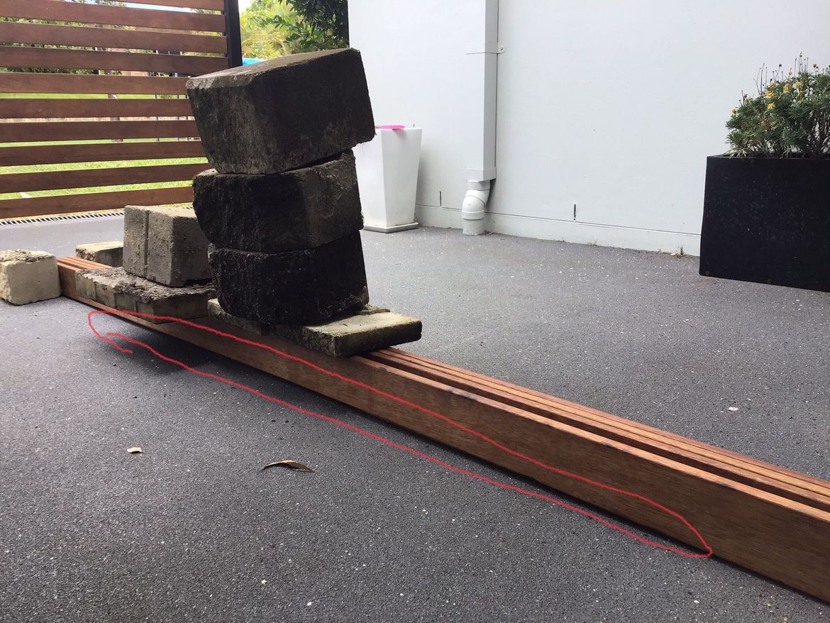

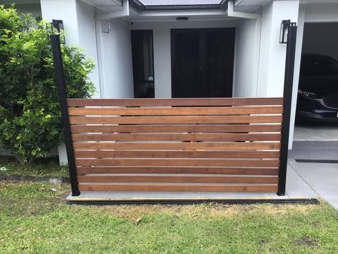

Hi Guys, I’m in the middle of building a privacy screen with Merbau wood using the Jacks Screen Up system. Have got about half way through and noticed about 7 of my decking boards have bows in the centre. When placed in the screen up posts they don’t look horizontal at all. Any recommendations on the best way to try and straighten the bow. I only bought the decking this week from Bunnings. At the moment I have bricks on top of the middle hoping it will correct. Is it best to just return the 7 x 2.7m lengths or will the bricks work. 33BA40F7-EE90-4BDC-B965-30CDD9526916.jpegEC5C7DAA-4BA0-4DDE-9E40-DB4DF515C4EB.jpeg

Unfortunately, without attachment points, you don't have many options to straighten them out.

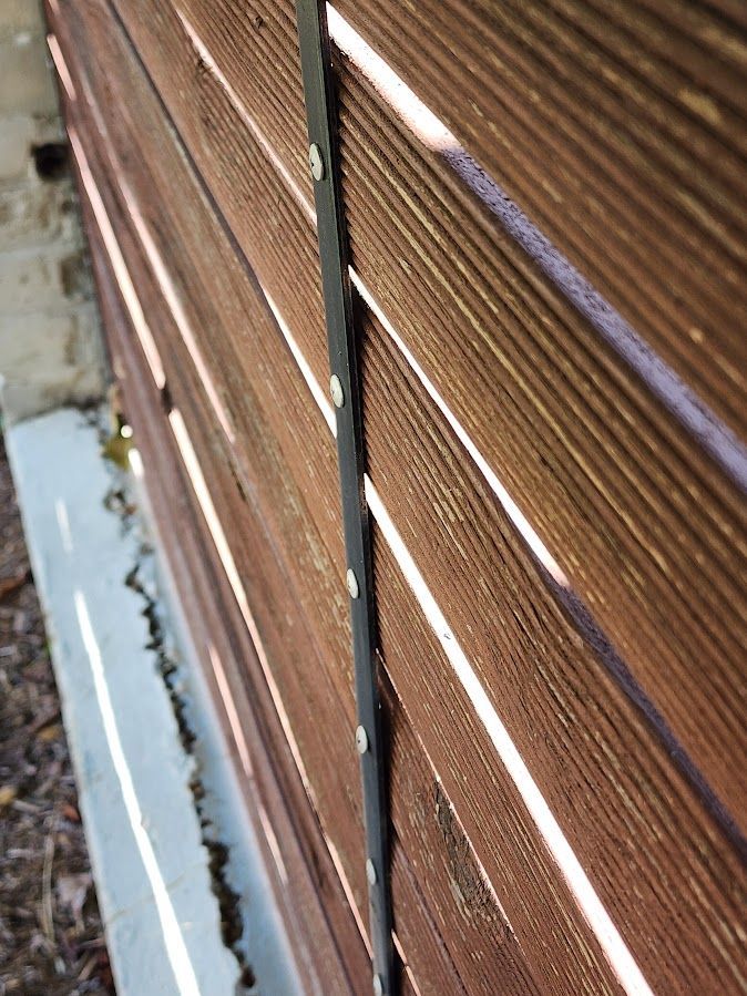

If you used a slat vertically at the centre of the span, you could pull the slight bow out and then screw them in place.
What you are doing with the bricks will certainly help, but if you can't get the bow out, you can always return them and select straighter pieces that you are happy with.
