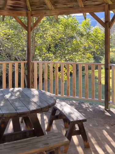

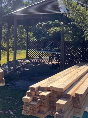

This gazebo was built 10-15 years ago and had lattice sidings that were rotting, and were built far too high that you couldn't see out while sitting. It was super dark inside, the vines had overgrown the structure and had become and eye-sore, so we decided to bring it back to life!

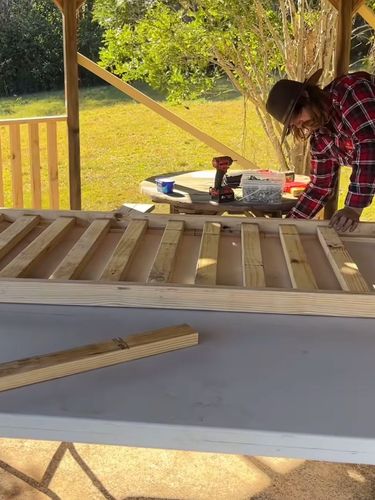

Remove sidings and brace existing structure. Measure and cut / mitre lengths for top and bottom edges, and individual railings. Keep in mind Australian standards for minimum heights for child safety.
Using a nail gun, slowly assemble the rails using packers beneath to make sure evenly placed / centred.
Place each railing in their new spot, and reinforce the structure at the beams so super strong to lean on.

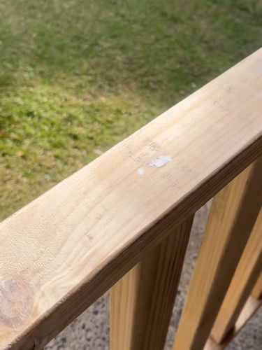

Spack fill the nail holes, let dry, sand back and dust off before painting.

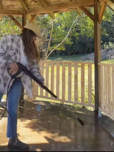

We gave everything a good clean with the water blaster and let it dry for a week before sealing. This ensured the paint was going onto a totally clean surface (free from the grime that had built up on ours over the years).

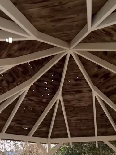

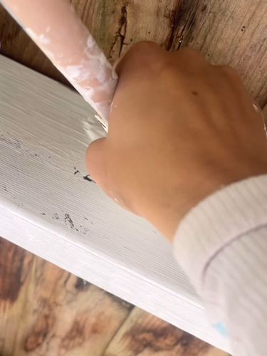

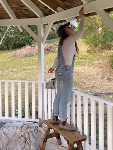

We carefully painted the beams on our vaulted ceiling as we wanted the height of our structure to 'pop'. This took 3 weekends and requires a steady hand (or a lot of masking).

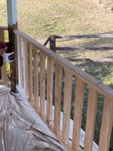

To make light work of the balustrade, we used a spray gun. We wore coveralls and chose a non-windy day to minimise drift. We tried for 2-3 coats.
Make sure you have the right things to stand on, and have a lot more paint than you think! Two coats requires a big big bucket!
We used a scaffold to reach the heights of our vaulted ceiling, and a tiny small brush to get in between the joins. It was a labour of love!
We installed our festoon lights with tack nails, a hammer and hung them on an angle which really added to the 'festive' feeling in the space. It also made the beams glow and made the cables look pretty and not obvious hanging directly in front of the beams.
