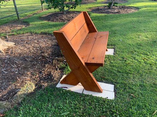

Gday just want to thank everyone for the advice on what to finish my garden bench seat with so it wouldn’t rot.
Purchased all my products for the entire job from Bunnings.
If anyone is interested in making one themselves just PM me and I will give details.
Next project birdhouse!

Fantastic work, @Jim57; I love the design you've chosen. That tapered cut you've done on the backrest support really adds a nice contemporary touch.
I'm sure there will be plenty of members interested in building one of these, so if you could provide as much detail as possible here, that would be appreciated.
Well done, and I look forward to seeing what project you tackle next.

Well done @Jim57. We love it when community members come back and share their finished projects. It's very inspiring and helpful to others. If you could share as much detail as possible and what you learned along the way, I'm sure other members would really appreciate it.
Thanks again for sharing.

@Jim57 this looks fantastic! You might want to consider posting the step by step publicly, I Know members would appreciate being able to follow your build instantly to create their own versions. Well done on this

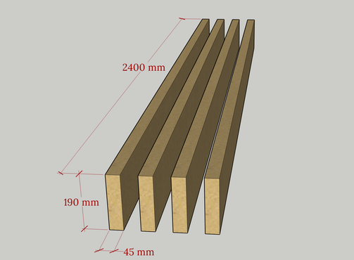

I have put the bench together in rendering software based on the video and created something you should be able to use. Note that I have converted everything from imperial to metric to make it as easy as possible.
Start by purchasing 4 x 2.4m lengths of 190 x 45mm H3 Treated Pine and a box of 75mm galvanised batten screws.
Cut two of your lengths of timber in half. You will now have 4 x 1.2m lengths that will make up the backrest and bench on the seat.
