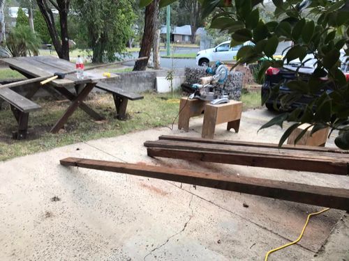

I had finished the timber for the table and thought If I cut the bench seat timber now then I dont need to drag out the drop saw tomorrow.... Cutting after denailing the old timber.... That was a pain...

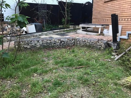

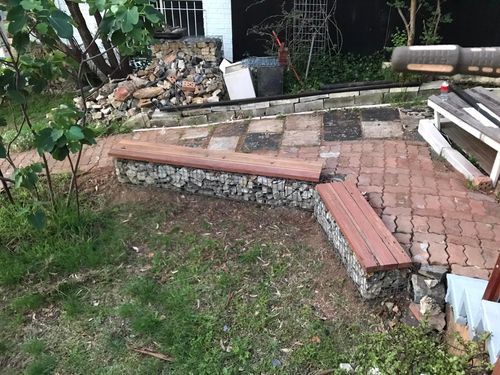

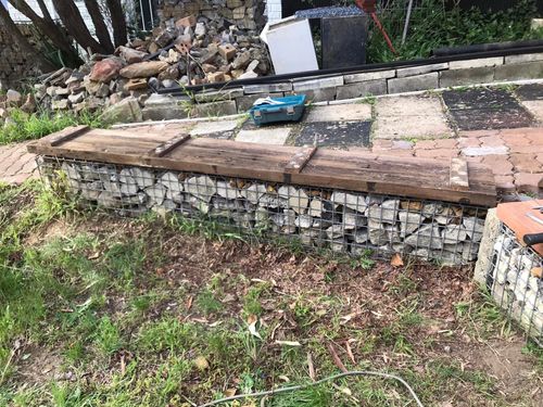

Before I started and yeah the glossy golf grass no longer exists 😕 The first heat we had after I planted the grass seed wiped it out.

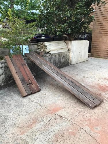

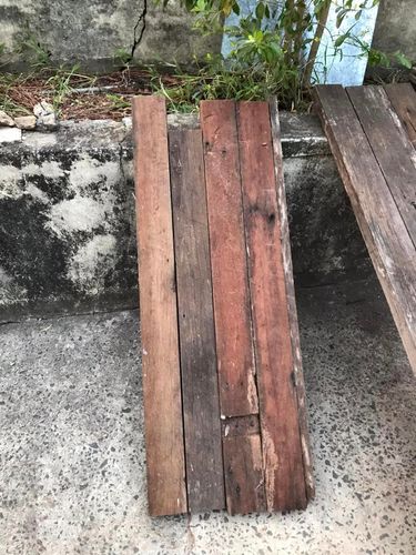

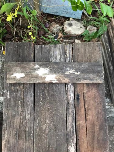

Laying out the timber to make sure I had cut it properly.

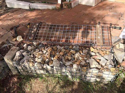

I screwed two piece across the 4 pieces, this what I use to keep them all inline. Taking off the lid was easy as it was just unwinding the wire screws.

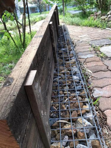

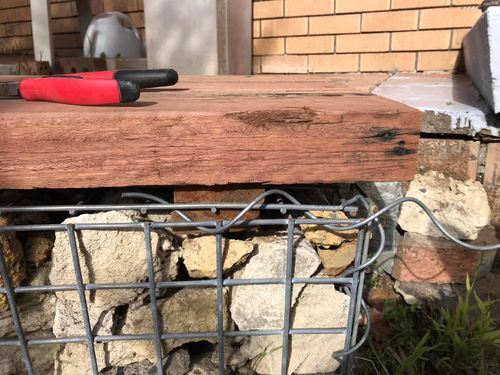

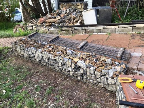

Then I screwed through another piece of timber, through the mesh to lock it to the cages lid. I removed a few rocks to make space for the timber strip of merabu on the underside of the cage lid.
I had planned the timber before I attached it to the lid. Gave it a beveled edge as well. For the small cage the screws went back on easily.

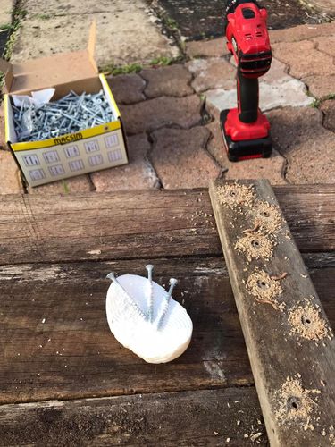

Bunnings guy told me about rolling the timber screw in soap first before screwing into the predrilled hole. Makes life so much easier. I used my decking screws to attach the base plate to the 4 piece lid and then more decking screws to attach the timber to the lid with the mesh in between.

Attaching the base strips, also removing the stones where the timber strips would rest

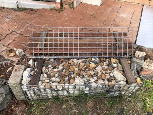

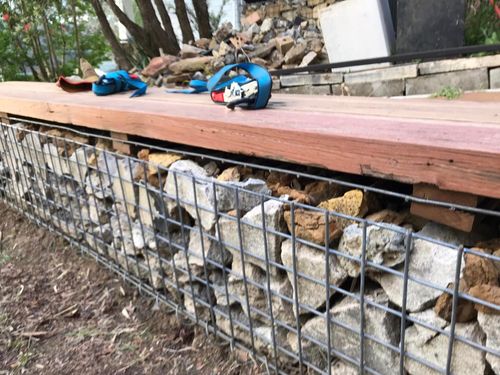

Mmmm, and the ratchet straps are what I use to bring the side of the cage towards the top of the cage.
Fairly big gap and man it was painful to do. Too full of rocks and too tight a spiral made life difficult

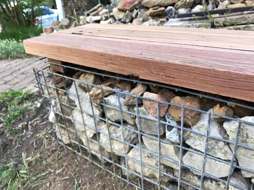

The gap was larger then I expected and by all rights I should have removed some of the rocks alongside the edge that would require the corkscrews. I made it in the end but consistancy in the spiral would have made it easier.

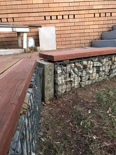

They really bring the area together. And yes I was stirred by my friends about my many weeds lol

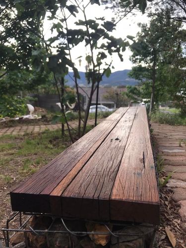

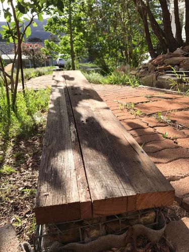

The timber had beautiful colours to them, With the extra spacer in the lid it worked well.

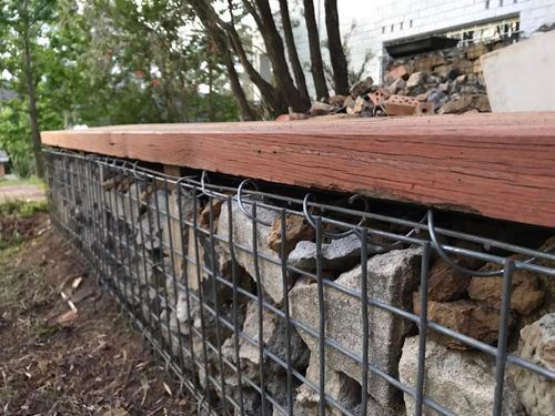

Normally the spirals would look a lot tider but the physical space I had left and not removing some rocks made the job harder to wind them back on. In the end I went for a shorter spiral length but more of them.

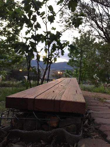

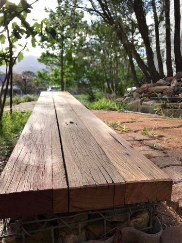

The planned timber made it shine.

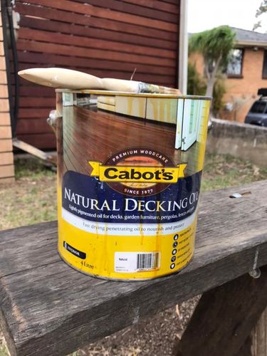

Last step was to oil the timbers. I remember seeing some timber oil under the house when I was getting the mower petrol out. I thought Id have a look and sure enough had around half a can. The oil looked ok and didnt smell so thought why not.
The timber drank the oli tho not as much as the non planned timber for the table setting.

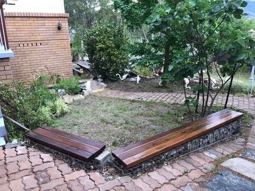

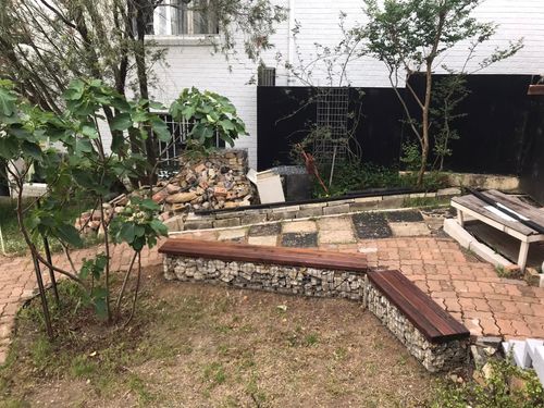

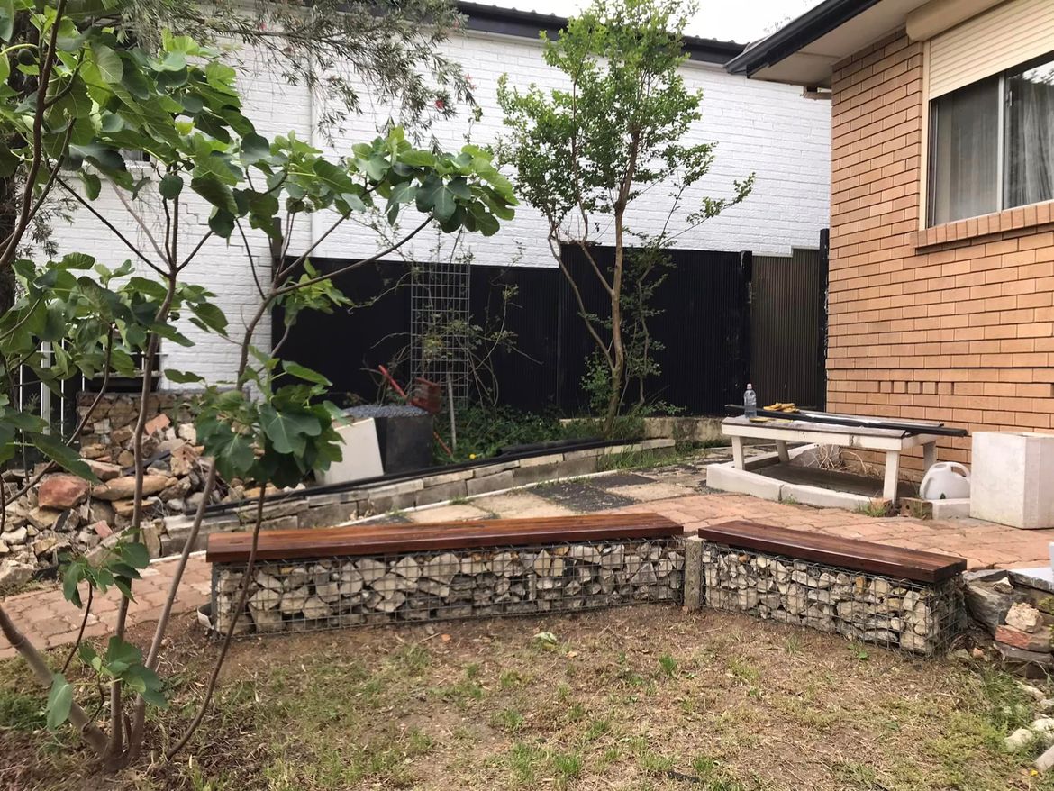

Much nicer, the rocks/concrete are for another gabion wall around the other side of the house. They are just stockpiled for now :smile:

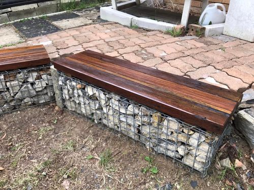

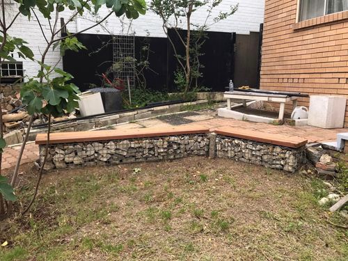

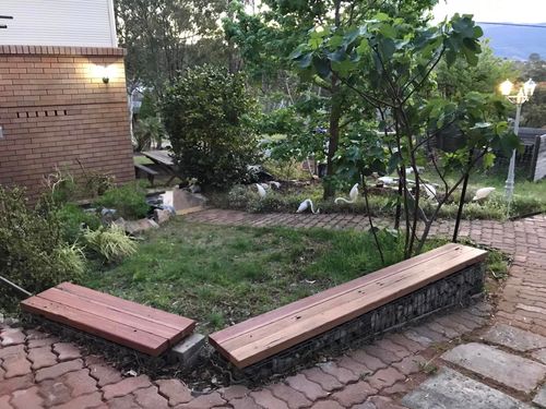

Yep.... All done and they turned out a treat. I made sure I used timber strips, 100mm timber, 20mm timber strip, 100mm and 100mm strip on both seats so they would match. Its raining at home apparently so cant wait to go home and check them out :surprised: (came home and the timber had water sitting ontop )
