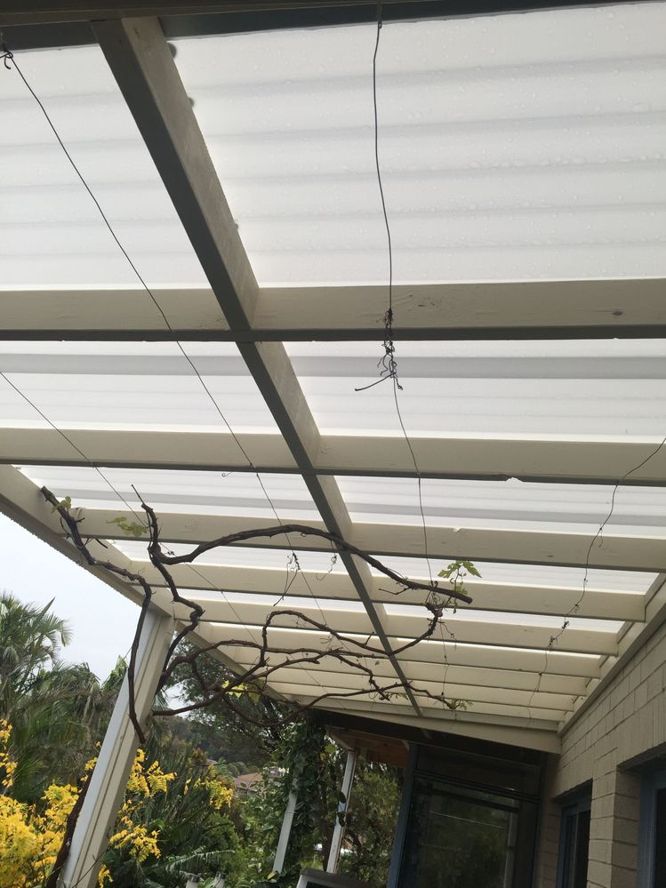

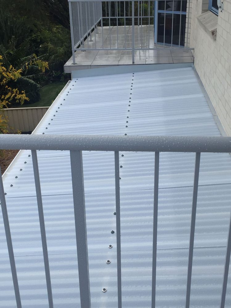

IMG_1291.JPGIMG_1299.JPGWell, I have "finished". I hope to attach a photo. The flashing on the edges are Gal and I will have to replace them from time-to-time because of the proximity to the ocean. I just siliconed the Gal to the tiles and it leaks there. Not surprised. Will add a silicon bead along the top when it has all dried out. Perhaps the bead I put in behind the Gal was not continuous. Not ideal, but I didn't want to put holes in the tiles as the substrate behind is Hebel and I have just "finished" cutting out the rusted rio in the planks and re-rendering overhead (never want to do that again!). Also I screwed the Suntuf down on the wall end in the valleys. I know this is wrong but I figures
1.the high side of the sheets would be fairly safe,
2. I siliconed the screws to put off their rusting
3. the verandah below is just that and not a sealed up room
4. the heads of the roofing screws would prevent the aluminium angle from sitting neatly on the top of the Suntuf.
Also, I omitted to predrill the Suntuf. I screwed it down before I got the word to do so. I did know this was recommended but when I researched it I read that since the roofing screws are self drilling now, it wouldn't be necessary.....wrong, I think. Perhaps this is why the edges of the sheets are curling up a little?
I learned quite a lot and will be putting the same sort of roof over the verandah's above this one. Thanks for your advice, will see how it goes and make the necessary adjustments for the next ones.

Very nicely done! It's always a win when in the middle of a Reno you get new knowledge from first hand experience. From the pictures you posted it looks expertly done. I reckon your next roofing project should be perfect as you've picked up more information about the process. As to adding an extra bead at the top of the galv flashing may I suggest Selleys Storm silicone seal. It is an all weather sealer that should provide you with a superior seal against harsh weather. Looking forward to your next project!
