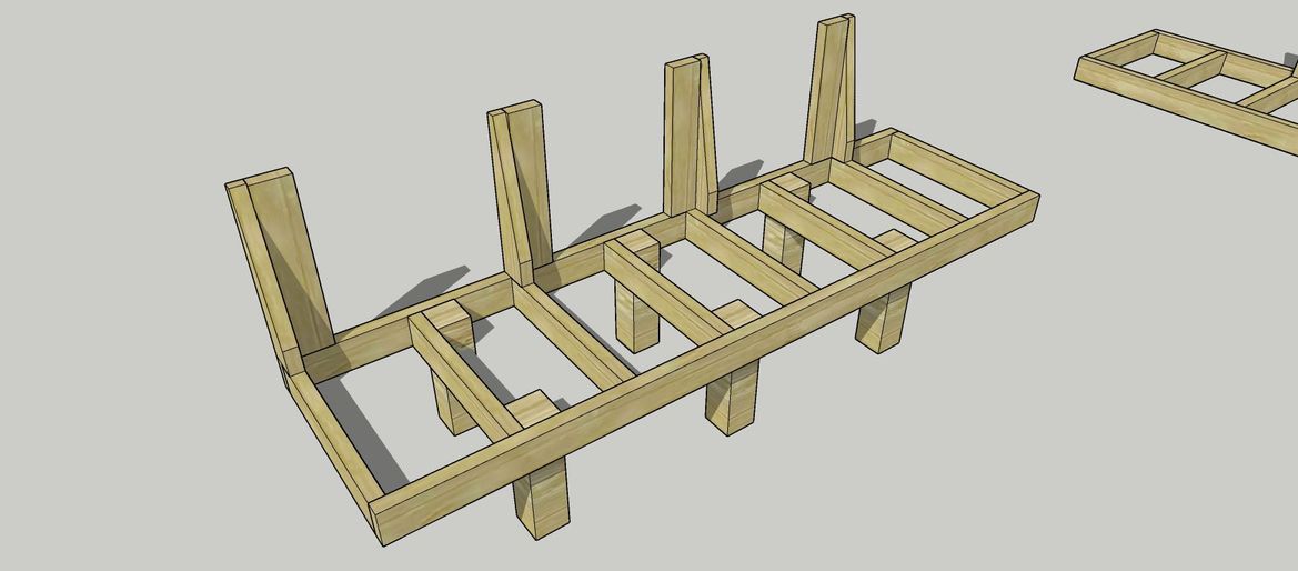

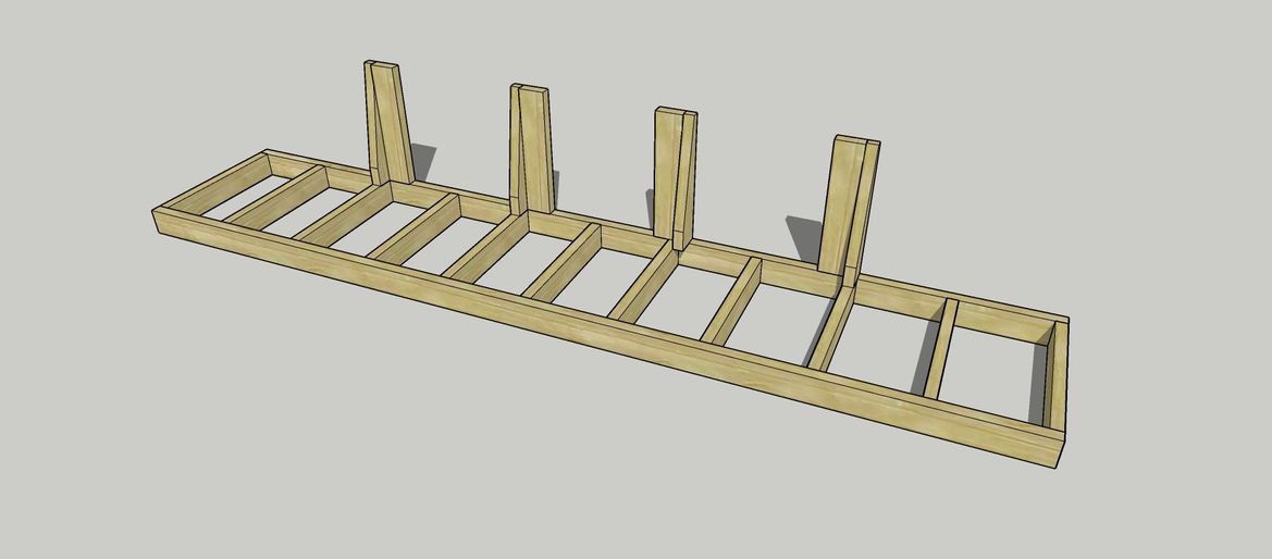

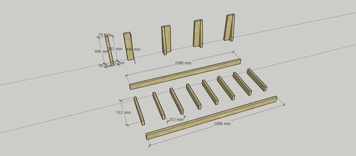

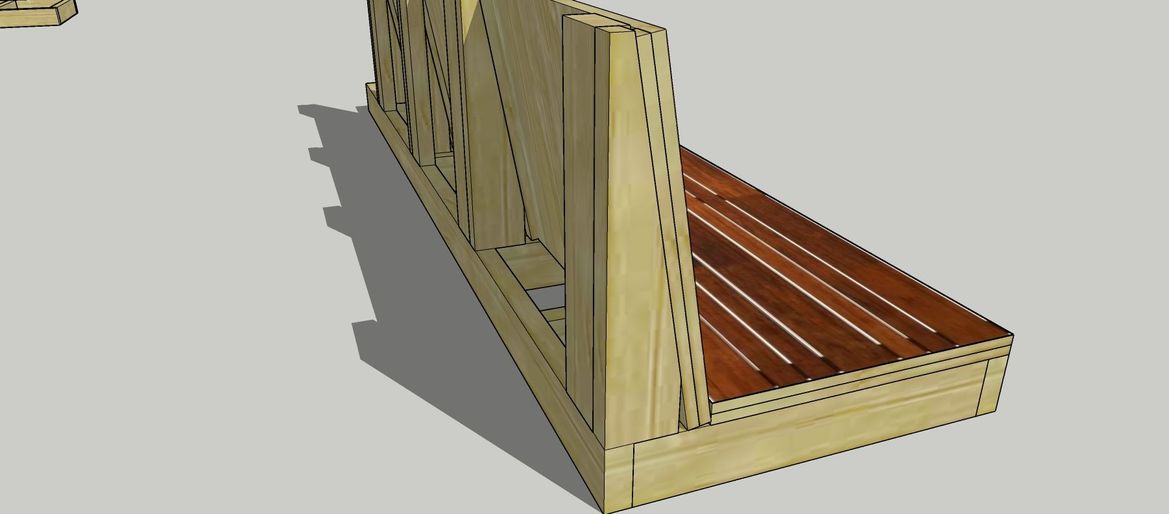

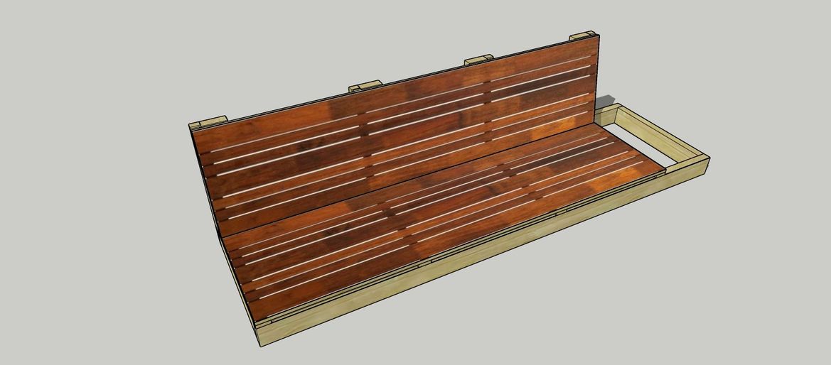

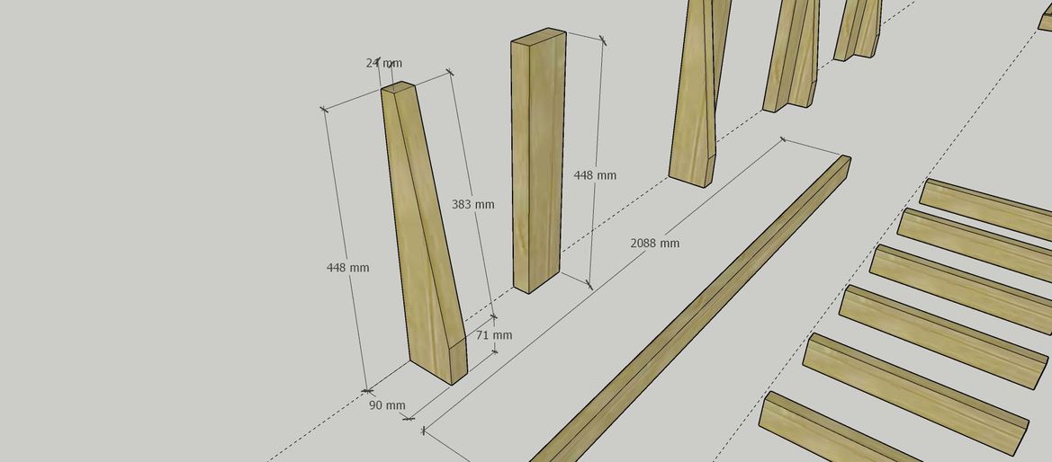

custom seat & utilising the merbau panels for a great result
all built for our measurements & safety requirements for the pool ect
