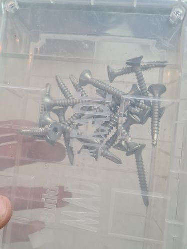

You should fix your 70x35 treated pine frame to the top and bottom rails with these screws. You'll probably struggle to do it with a drill driver. Impact driver is best or a hammer drill should do.
And you need to clamp the timber to the Colorbond as close to your drilling point as possible because once the screw penetrates the timber and begins drilling into the steel it'll have resistance and will push the timber off the fence.
Hope this helps.
