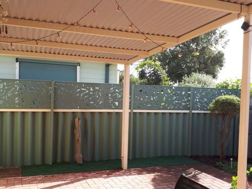

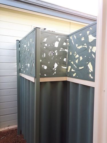

 Well, the fence extension is now finished and I am very happy with the results,
thanks to Bunnings for great advice and prompt delivery,
and to Barry for doing all the hard work :smile:
I painted the posts with primer then 2 coats of Dulux Lush Hosta before installing.

Hi @Grangela,
Well, didn't that come out fantastic, kudos to you! You must be very happy with the end result as Barry's installation job looks very professionally done indeed. Now it's time to sit back and enjoy the view.
Many thanks for updating us on your project and we look forward to hearing about your next one.
