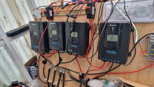

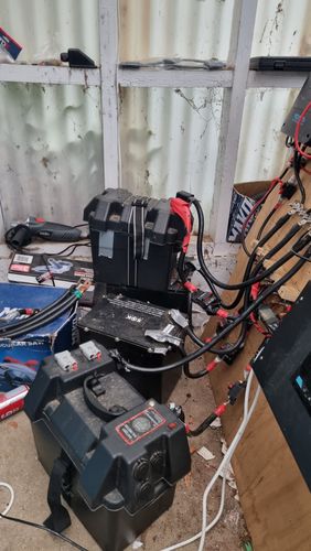

I'm across the ditch in Aotearoa NZ, and at the Southern End, in Dunedin.
I bought 2 × 12V 206Ah LiFePO4 batteries, each cost about NZD1700, so NZD3400 for 5.4kWh - I could run a 1000W appliance for over 5 hours.
I found that it is straightforward to make the battery yourself. You need the cells, and a BMS, and doing this reduced the next 2 × 12V 206Ah LiFePO4 batteries to NZD2000 in total. Now I have 10kWh storage, which is the difficult (expensive) part. Presently I have 2345W of solar panels, but the wattage of a panel is its ideal output, and not a guaranteed result that'd give me 2.3kWh every hour. I power my fridges, freezers, dehumidifier, microwave, and induction elements from the inverter - not all at once, my inverter is 3000W, and also has UPS to draw from mains if/when the batteries are too low. My electricity bills are 1/3 to 1/2 what they were. When there's a surfeit of Sun, I do extra loads of washing, and the dishwasher, and run the dehumidifier hard, all of these are powered by the Sun, not drawing from the battery - it's a cash job, and not need bother the bank/battery.
A 6kW system usually means one can draw 6000W, but if your power bill shows your use per hour or half hour, that is a big draw - running a diswasher, microwave, and boiling the jug would about right, but if you do them consecutively, you wouldn't go over a 3kW draw. LiFePO4/LFP batteries are expensive, but they are extremely easy and no maintenance. You can discharge them fully (to the inverter changing to mains, or BMS protection engages), they don't mind, whereas Lead-Acid can only be discharged halfway, and demand attention.
It's been a fun project, and thoroughly recommend giving it a crack.
