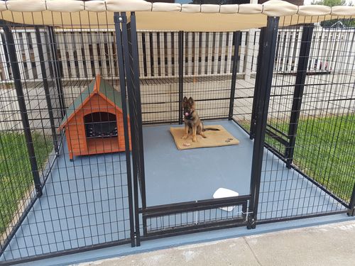

Kennel.jpgMeet Edward
He loves his new home.
Measures 3 by 3 mts so plenty of room.

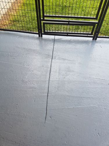

Its my first slab so not everything went to plan. There is a slight dip in the middle so water is building up when it rains. I will use a angle grinder to carve out a little channel so the water can run out.
Took me about 4 days, 2 days digging out by hand, back ache and buckets. About a day prepping the slab ready for the pour. Then a day for the pour, mixing about 3 tons of concreate.
The Ozito cement mixer is gold, fully loaded it and pushed it to the limit and it performed 100%. I thought being the cheapest it will do for a one off job, well, this thing is a beast, will now use it to mix for fencing posts etc. Defo worth buying this beast.

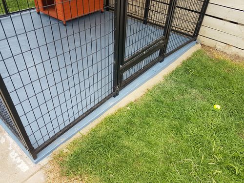

Update
Painted the concreate slab, this will make it easier to hose down and clean. Also used a grinder to create a drainage channel.
Put gravel and sand drainage ditch in the sides.
