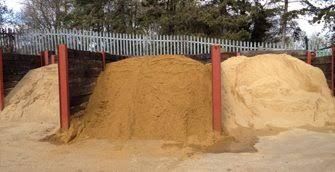

Just looking for guidance on what I'd need from Bunnings for some DIY aggregate bays similar to the photo?
I'm wanting the walls/dividers to be 1500mm high, 3m wide and 4m deep and 4 bays.
Thanks

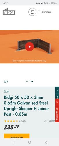

Would the Ridgi range of products not be suitable for this?
Re: Diy aggregate storage bays
Hi @Char1991,
Yes, the Ridgi system would be suitable for your project. We also have the Galintel 100 x 1200mm Galvanised Steel Heavy Duty Retaining Wall Post H-Section if you were looking for something more heavy-duty.
