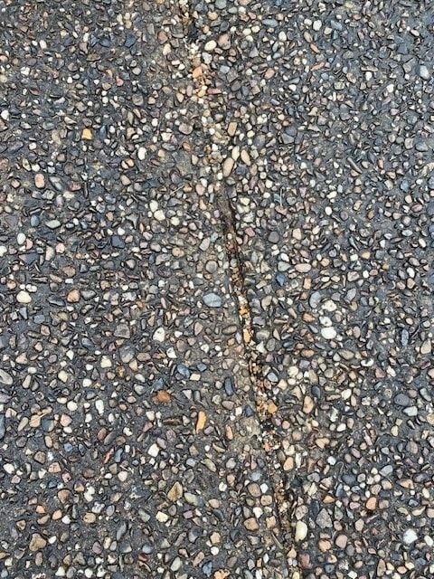

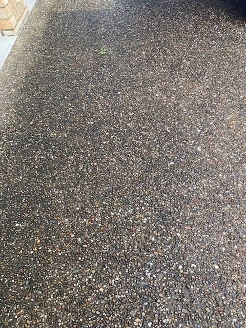

Hi, My pebble driveaway now has loose pebbles coming up all over it and is really difficult to walk om in bare feet now/. It clearly needs re-lacquering of some sort nut not sure ow to go about it. Any assistance would be appreciated (note pictures below- driveway wet).

There is no GT all your stones will stay in place forever but the following product will lock the stones in as well as possible, This  sealer  designed for agrate  and will  protect the surface from  wear,.
Now your pebbles are looking like they need a good hi pressure  wash to pre clean them by all means do this but not at point blank range  as all your pebbles might wash out. Hold the wand up higher so you get a clean but not cutting stones out.
No need to brush all the loose pebble crete stones off as formulation will glue them down some what.  Some  may still come lose.
Search  for suppliers for nu tech Argeseal approx $250  for 20L
