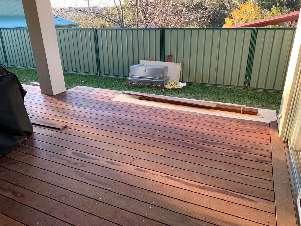

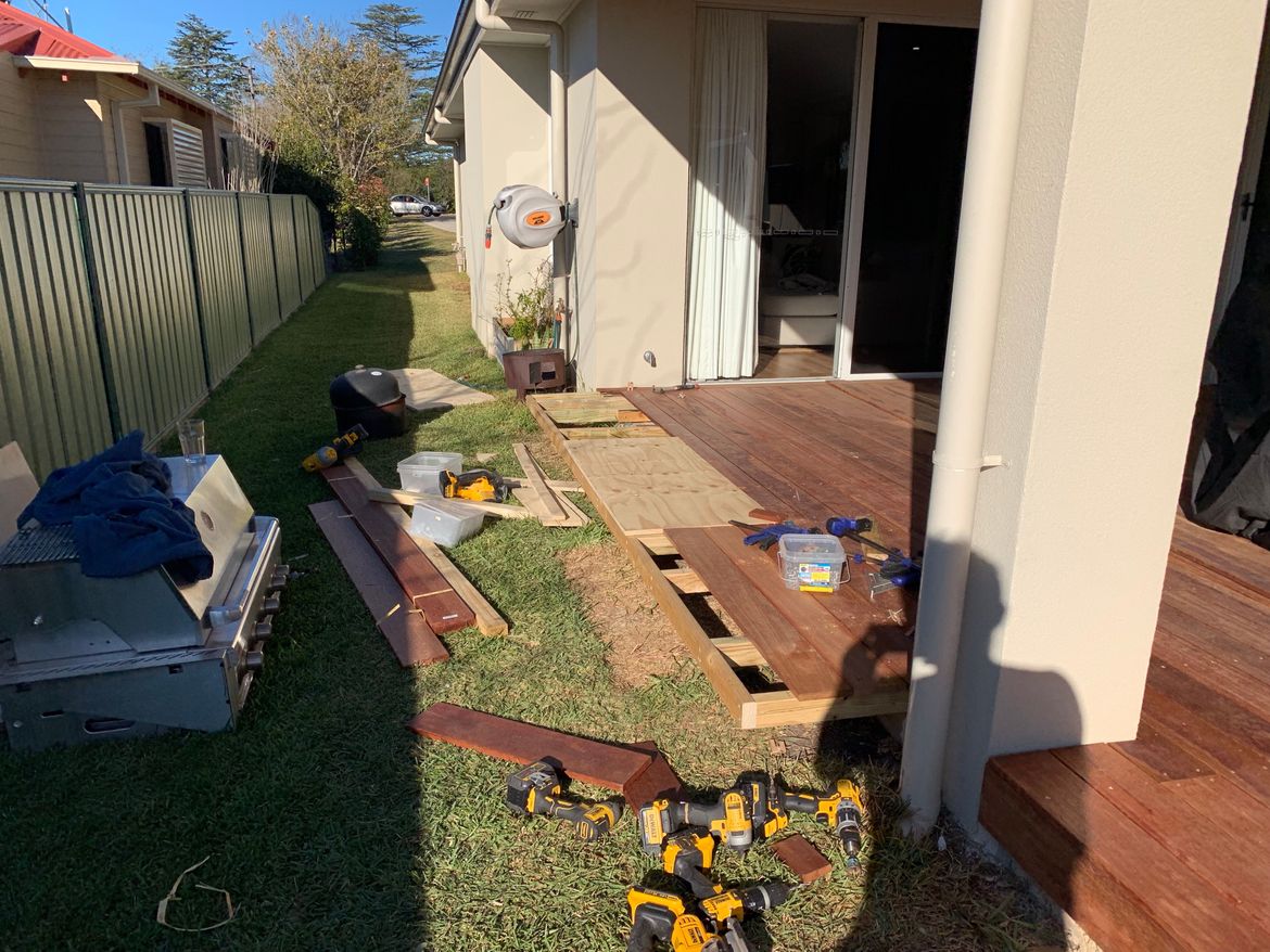

I cant remember precisely the width is about 4500 I think I put them at around 800, I just used blue plugs and batten screws to hold in place. Since the weight of the deck itself and no upward forces I went easy on the fixings to the concrete. I have since made some additions for those who are interested.
Simple cantilever to support BBQ & stone benchtop, plywood flooring, cabinetry to come shortly.
Cantilever deck extension for built in BBQ

Hey could anyone tell me what the black material is on the top of the joists in the photos of this deck? I'm doing the same board over and alfresco area and am worried about cupping. Any ideas to prevent this?
Re: Decking over concrete slab
The black material on the joists is just black paint, this is so that the joists cannot be seen through the decking spaces. Given you have sufficient gap between the concrete and decking with wide enough gaps between boards you shouldn't have a problem, we gapped ours at 5mm and the deck sits barely 45mm off the concrete. We also screwed in wider spacing the screws 30mm and 110mm on 140mm boards.

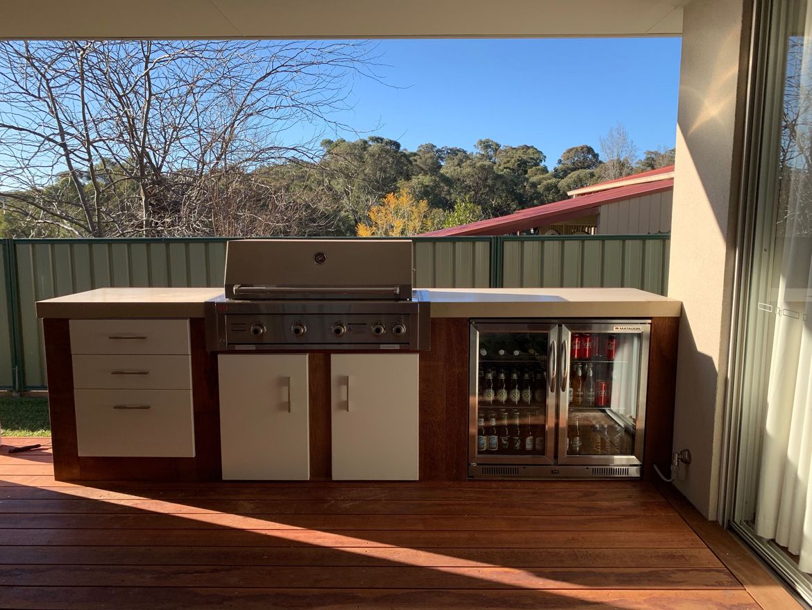

Just a photo update on the threat - BBQ complete.
