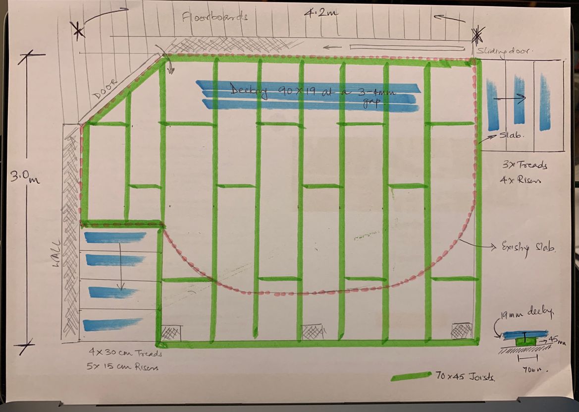

First time post'er. Looking at installing a timber decking (90x19) on a concrete patio (red dotted line). The Concrete Slab also has ceramic tiles on it that i might need to drill through.
The slab is 75 mm below the house floorboards (door on top left that opens outwards). I would like to have the decking just below the floorboards (if not flushed).
Decking is 4.2m L and 3.0 m W. There are steps going down (bottom left and top right) as shown in drawing that I would like to cover with decking (blue highlighter marks showing direction of laying).
Joists are 70x45, laying them as shown (green highlighter), 70 wide and 45 high. That way, 45 + 19 (decking) gives me about 65cm. I am still unsure if I need to anchor the joists onto the concrete slab (through the ceramic tiles). Need some clarity on this and whats the minimum number i can get away with?
I was also thinking of using those spacers/footing protectors attached under the joists at regular intervals all through so that there is about a 5 mm gap under the joists and it doesnt come in direct contact with the ceramic tiles and has space for any water to run off.
The slab is curved (as shown), but I am making the decking rectangular so it will jut out and plan to support it with 3 posts (90x90). The height of the decking where the posts are going down will be 600 from the ground. So, i plan on taking the posts 450 deep in the ground and the balance 600 above ground.
Plan on using 10G-50mm SS screws (countersunk), Zenith?
Area is exposed and is North facing, exposed to run/no cover.

Do I need to dyna bolt the joists, if so, whats the least i can get away with? I will be staggering joists supports as shown.

Would love for you experts to cast your eyes on this post and the attached drawing and let me know if there are any gotcha's or things i might have missed (or validate some of my thoughts).

Rough sketch of the proposed decking

3. The overhang section (the bottom side of the pic) is the area where the decking will be off the slab, but will be supported by 3 posts (the shaded squares along the bottom bearer). Wouldn't that be enough? Do you recommend that I add noggins along that span in the overhang section to give it additional strength.
4. Noted on the dyna-bolt at 1m spacing. Will I need to bolt down the joists/bearer around the periphery (section over the slab) as well? Also, what size dyna bolts would you recommend as I will be drilling through PORCELAIN tiles that are stuck on the concrete slab.

The 90mm timber has more mass and therefore can support more weight. This might not be an issue if it is properly supported by shims but my advice also relates to my other comment about the section overhanging the concrete. Please check with Building Code of Australia and relevant span tables to see if 70 x 45mm timber on its side is suitable for joists/bearers in this application.
The far-right joist seems to have an unsupported span of around 1.5m. This is too large for 70 x 45mm timber laid on its side.
Please bear in mind you are not building a deck to support its own weight, it needs to meet requirements in supporting a minimum kilogram per square meter. Your 70 x 45mm timber needs to support BBQ's, table settings, a mass gathering of people etc. As mentioned before the BCA and timber span tables tell you how timber needs to be supported to meet minimum requirements.
Ideally, you'd have all structural timber, excluding noggins, either supported or bolted down. I'd recommend Ramset 10 x 100mm Countersunk DynaBolt Plus Masonry Anchors. That would account for the 45mm of timber, 10mm of tile and leave 45mm of the bolt in the concrete.

The far right & the bottom (along the posts) bearers, i can easily fix them 90 high x 45 wide as they will be off the concrete. Infact, the more I think about it, that would definitely be a better option.

Attaching joists:
1. Using a Galvanised angle and dynabolting that and then screwing that to the joists? OR Dynabolting through the joists to the slab directly?
2. Fixing the joists to the bearers (even though they are both 90x45), are there any joist hangers that I can use to get a good perpendicular fit?
3. How deep should the posts be in the ground that I was going to set in with some rapid set concrete. 400 deep is ok?
4. Can you point me to articles/link regarding framing the decking please. I understand that framing along the sides gives the decking a much better look, we overhang the framing by 20 so that the side decking (vertical) will fit under that overhang and finish nicely.

I feel bolting straight through the joist is a more direct and positive fixing. There are no joist hangers that I am aware of to suit 90 or 70mm wide joists laid on their side as it is not a typical construction technique. Footer requirements are generally site-specific and your local council should be able to advise further.

If you want the side trim decking pieces underneath the decking, I believe you would set the framing back in 19mm from the overall size and overhang the decking from it by 19mm. That way the side trim pieces of the deck will sit underneath the top boards.
