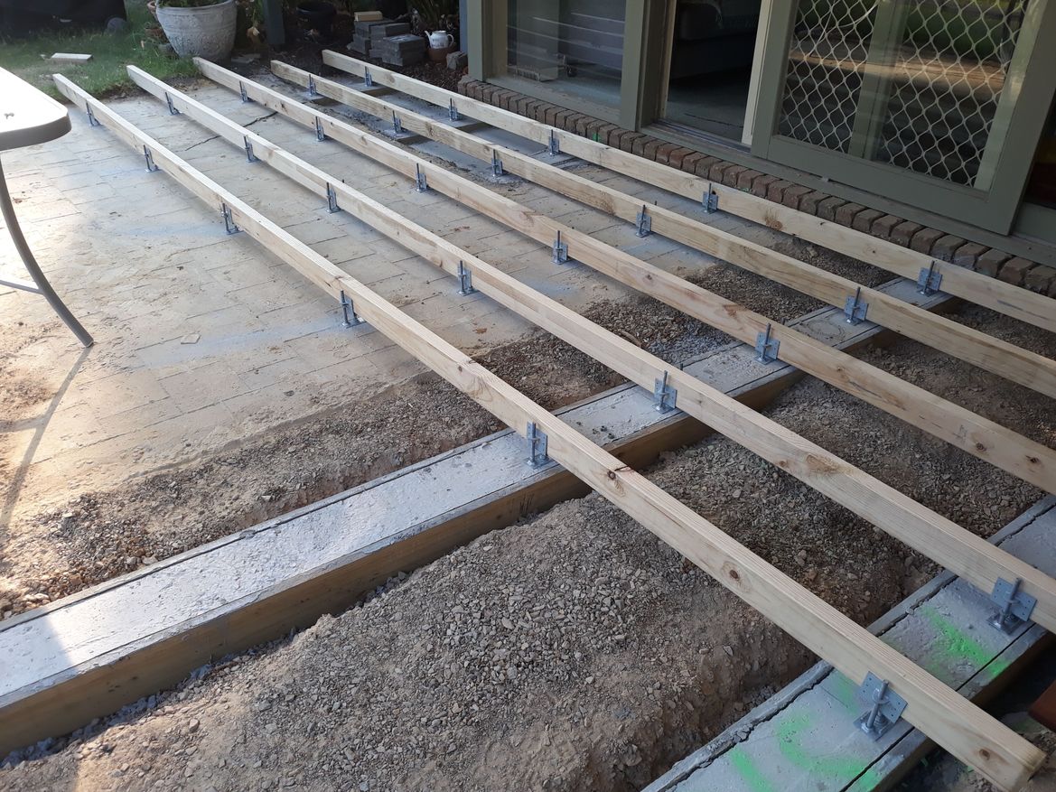

I'm not sure if I'm too late to the party but another solution you could use for your decking over the concrete slab is a product called KlevaKlip joist Support.
They aren't a bunnings product unfortunately but are available throughout Australia and are great for doing decks on concrete slabs as they allow you to level the joists regardless of the fall on the concrete slab...
Also using these would not require the use of bearers. https://www.klevaklip.com.au/images/WordDocUploads/KK_BP_P3A4%20April%20_AJS.pdf
I've attached a photo of it in use for a deck I built for my mum back in last February and then a completed picture of the deck.
Let me know if you have any questions.
