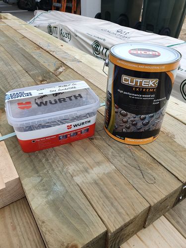

For me, you can't go past Cutek Extreme. It's a top quality product and one I've used several times myself. I know some carpenters and a couple of building supplies companies that use/recommend it too. It gives a beautifully natural finish (without tinting), is long lasting and has the versatility of being tinted to your desired colour/tone. I've always found the timber I've applied it to is well preserved over the years. (I don't benefit from the "promotion" of this product)
Unfortunately it's not available at Bunnings, but I have always heard good things about Cabot's and Feast & Watson (which are available at Bunnings) too.
Keen to hear from others.
PS WÜRTH SS decking screws FTW.
