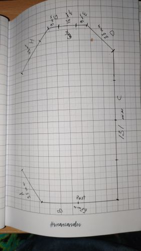

Then we got a small sketch of the measurements and an idea of how many polls, fences, dynabolts, bracket, latches and so on.

Rough Sketch Rough Sketch
