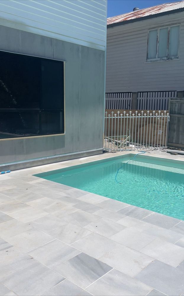

Here’s a before Picture

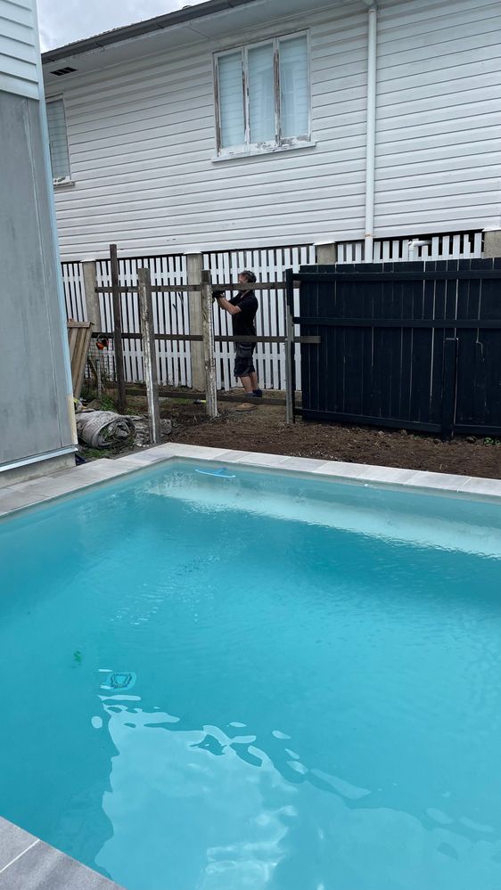

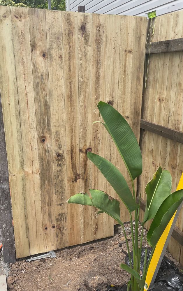

To remain budget-friendly we kept the original fence to the side of the pool, it was looking a little ordinary but was in good condition. To ensure compliance we needed to extend the fence and add a return from the new fence to the house.
Fence Extension
The original wooden fence was joined with chainlink fence.
We ran a string line to ensure the new fence was inline with the existing fence and bolted the new timber posts to the existing chainlink fence posts, as these had been concreted in place previously.
We installed 3 fence rails overlapping the existing wooden post.
We set the stringline on the top of the fence pickets to ensure they remain at the same height of the existing fence.
Installed the fence pickets using a coil nailer with galvanised ring shank nails (2 nails at each rail - each picket had 6 nails), raising each picket to touch the string line, using a level at the side of each picket to ensure its straight.

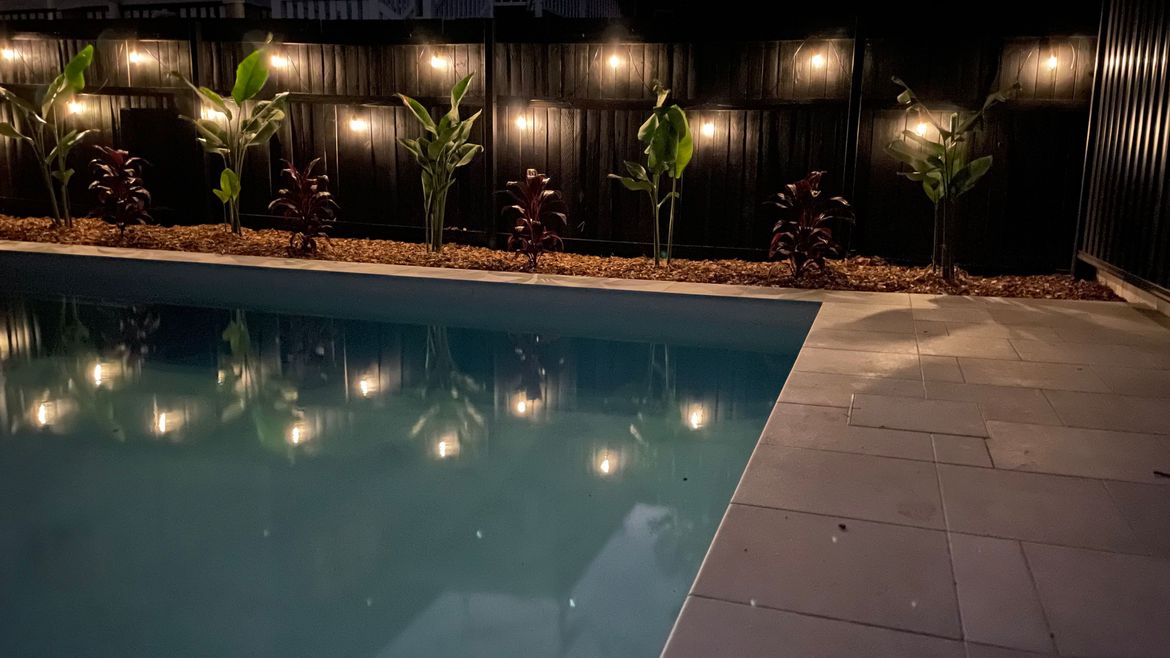

We have a 10m x 1.2m that gets full sun for most of the day. We wanted to add a low maintenance garden that didn’t shed into the pool (we have enough cleaning with 3 kids and 3 dogs). Privacy was also paramount as our neighbour's deck overlooks our pool area. For that reason we chose Heliconia RAULINIANA, they grow up to 4.5m tall and thicken at the base without taking over. To stick to our budget we chose to purchase young Heliconia’s, the more mature (and larger) they are, the higher they are in price so we saved a lot of money by deciding to be patient and letting them grow.
Due to the size they will grow they needed to be spaced min 1.5m apart and approx .75m from the fence. Usually I’m a relatively haphazard planter but as the area is a focal point I wanted to be precise to avoid any gaps.
After mapping out the garden and dividing the space, we could space them 1.6m apart to ensure consistency across the garden. Using a tape measure I measured from centre to centre of the heliconias and measured from the tile to the centre of the plant to ensure it was centre of the garden. (I chose not to measure from the fence in case there was a variation.
I then planted the Cordylines slightly in front and centre of the line of heliconias, to allow the heliconias more space to grow and add a pop of colour.

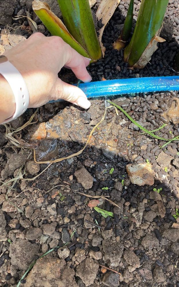

Irrigation & Mulch
Although I love to garden, I have a relatively brown thumb, so I need to add irrigation to keep the garden alive. We used a soaker hose and ran it the length of the garden; one end connects to the garden hose, it’s a straightforward system. The soaker hose holes are on one side of the hose so we used landscaping pegs to secure the hose in place with the holes facing down.
We added hardwood mulch over the garden to finish it off.

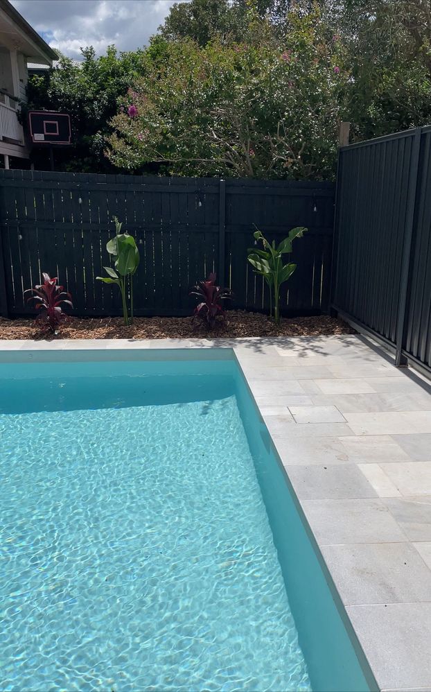

Back fence install a Stratco Fence

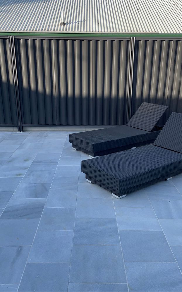

For privacy and consistency we installed a Colorbond fence along the backwall.
It ended up taking a few days to measure and build the frames. The frame came unassembled and in standard lengths, each post was cut to length using a grinder.
We built the frames on the ground, then carried them over and installed them. We used shark fin base over the pool tile; these needed to be drilled in place. The posts outside of the pool area were concreted into place.
Once the frames were in place it was smooth sailing and the fencing sheets were slotted into place and the cap readjusted.

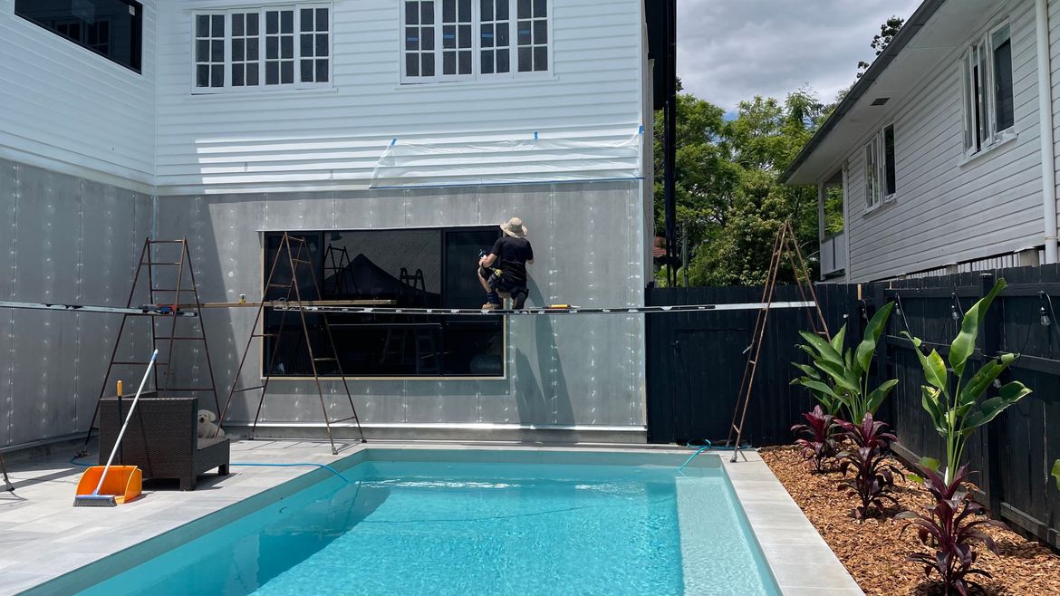

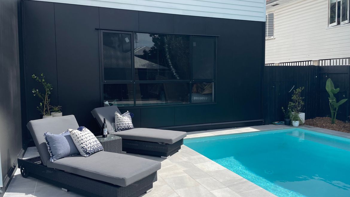

Paint

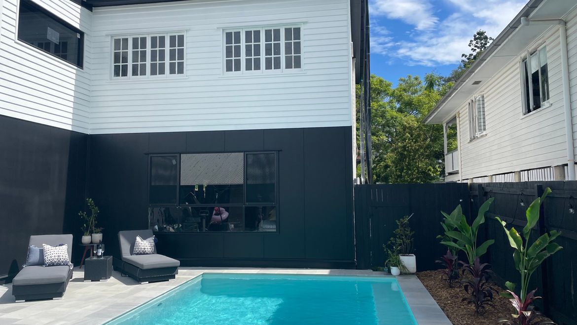

The final step in this pool area makeover was paint. Initially we couldn’t decide what colour to paint the house, the top floor, the original Queenslander we had decided to paint vivid White and we could have played it safe and painted the whole house white to make it look and feel larger however I wanted the ground floor to effectively disappear allowing the Queenlander to take centre stage so ultimately chose to paint the ground floor Dulux Weathershield Night Sky, low sheen. We painted the fence, the facia and gutters the same colour.
