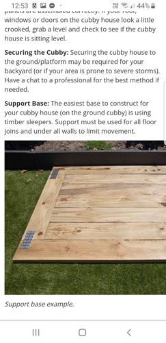

Or could we do something like this? Would this be ok?

It doesn't sound like you need it there for decades, so I'm not particularly concerned about it being so close to the ground. I'd suggest the most straightforward way would be to construct the frame with H4 treated pine sleepers, similar to what @weekenddiyer did. You can then just clad over the top with your decking so kids can't make contact with them. That will mean you can use whatever sleepers are available.
Since the sleepers are H4 treated, you can level the ground where they are going to sit and place them directly on it. Alternatively, you can use adjustable pedestal feet which will allow you to place the sleeper frame on uneven ground. It would be a good idea to place a paver under each of the feet to spread the load over a larger area. These pavers will be hidden under the platform.
