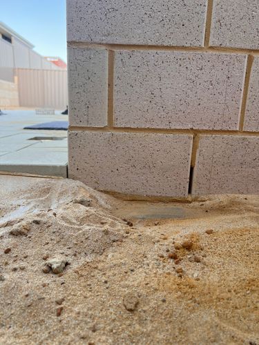

1. Existing garage slab and pavers are sitting above the foundation slab of the house, and appears to be at a level where they partially cover the weepholes (See first picture). I want to obviously do my own paving up to the same level so they’re flush, but is it going to pose any issues with drainage down the road with partially covering up the weepholes like existing pavers did?

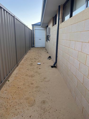

4. In ground services in the sideways. At the moment the PVC pipes protrudes above ground (See 2nd picture). I assume after paving, I can cut off excess so that it’s flushed?

  1. You should not block your weep holes as partially covering the weep holes with paving can restrict ventilation and drainage, potentially causing moisture issues. Ideally, you will dig down further, so your finished height of the pavers is below the weep holes.

  4. It is likely possible to reduce the height of the plumbing inspection points, but to be sure that you are compliant with the relevant plumbing standards, this is something you would need to confirm with a plumber.
