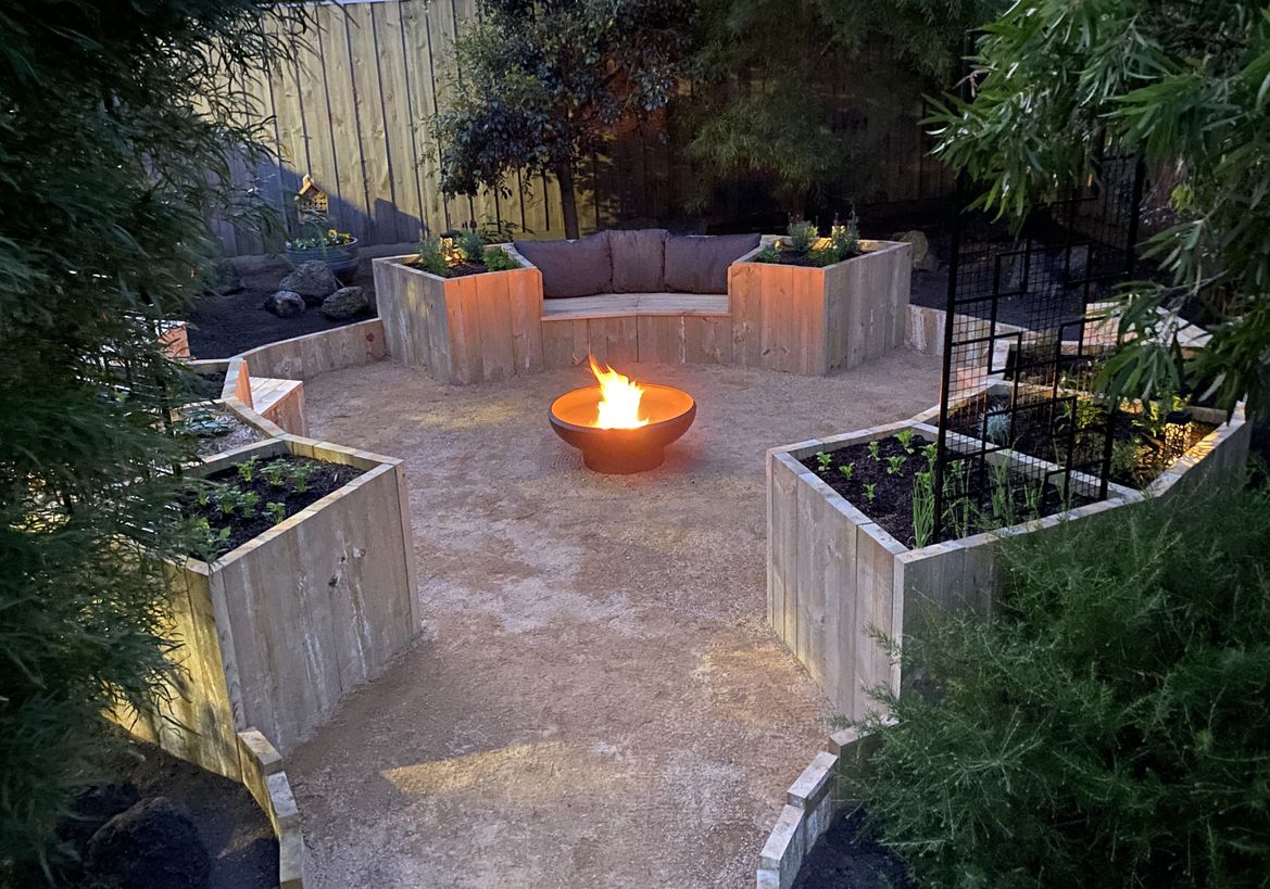

With the kids having outgrown the trampoline, we set about redeveloping the rear section of our garden.  With a roughly circular space of 4–5m diameter available we designed the garden to have eight planters, seating for four and space for additional seats if required. Sized to suit Bunnings treated pine sleepers cut to stand vertically, we were aiming for semi-rustic look. The seating was made using treated pine decking, and with the addition of four “Jack – Black Zen” plant trainers and our two year old Mimosa Fire Pit the project was complete.

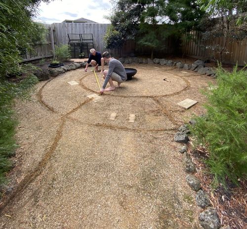

Measured the area available and then hand sketched and designed the layout of the planters and seating. The units were sized to suit the 200mm width of the sleepers keeping the front face of each section to three sleepers width. Working out the required quantities of wood we then ordered these for delivery, at the trade desk of our local Bunnings.
Step 2
Prepared the site, removed the existing rock retaining walls and pushed back the garden soil. Flattened the existing deco granite using a long piece of wood as a float and to check the level, then marked out the locations of each unit.

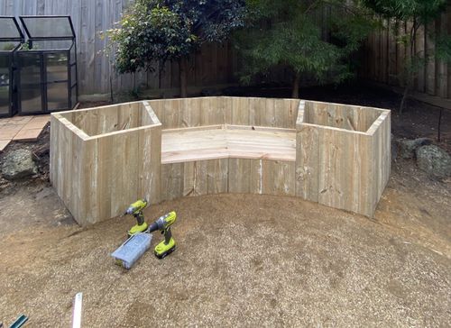

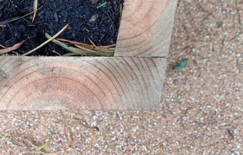

Cut the sleepers to length and bevel the edges at the correct angle for the joins between units.
Build each unit using the 70 x 35 for the frame and attach the prepared sleepers vertically.
Using off cuts to reinforce or close gaps between the sleepers as necessary.
Step 4

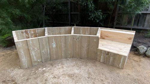

Position each unit and screw together, to create each of the three main sections, aligning these to ensure the positions are correct to allow for the retaining walls between these.
Cut and fit the pine decking to make the seating areas, this was done after the rest of the work on each section was complete to allow these to be custom cut to provide a neat finish on the joins.

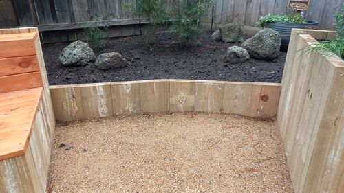

Build and install retaining walls between the main sections, again using offcuts to reinforce where required.
Oil the seating to provide weather protection and to provide a contrasting colour.

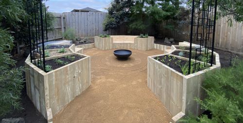

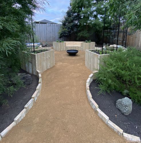

Back fill garden beds to the retaining walls, use sleeper offcuts to create the curved garden entrance, then smooth and compact the deco granite.
Fit the plant trainers, fill planters with a combination of soil / compost / potting mix, and plant a range of seasonal vegetables, herbs etc.

Add solar lights, locate fire pit in the centre, light fire and enjoy.
