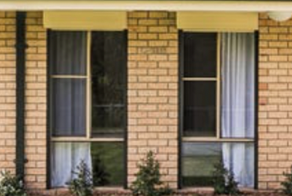

We have electric shutters on all the windows on our house, if I painted them black to match the aesthetic of the house exterior would that affect temperatures in the house? I don't have a photo of the shutters down sorry.

Thanks for sharing your question about painting your window shutters. According to studies made about heat absorption dark colours tend to absorb more radiated heat from sunlight while lighter colours reflect it. Therefore, painting your shutters black or a dark colour will make it absorb more heat.
In regards to painting them, I suggest having a look at this discussion - Spray painted screen door by @homeinmelbourne. The techniques used can be applied to your window shutters.
The general steps are to clean the shutters with soap and detergent. Use an etching primer on the surface before applying the topcoat. If you are doing a fair number of windows, it might be worth investing in an airless spray gun.
