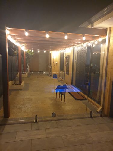

Built an arbour
Decided to try giving an arbor a crack in a bid to build a more enjoyable outdoor entertainment area.
At first i was going to get a metal gazebo built, but wife convinced me that an arbor would be better..
Started with a bunch of green cut jarrah from Austim, and then proceeded to clean it all up using mostly Makita tooling purchased at my local Ellenbrook Bunnings. Once wood was preped, Aquadeck (jarrah) decking oil was applied before some help from my friendly neighbours assisted me in lifting the beams into place.
This is easily the biggest home handyman project I've ever attempted and am stoked at the results. The wires were added today and paving cleaned up as well. Looks brilliant and the jarrah decking oil has grown on me after early reservations. Just need to convince the with to build a deck to really set this area alive!!
All tools and finishes were purchased from my local Ellenbrook store, which I'm glad to say had everything I needed straight away enabling me to complete this project within 4 days. Just need the grapes to grow now!
Cheers,
Shay
The green timber from Austim (jarrah).
Planed and sanded cuts.
Aquadeck jarrah decking oil applied (after Cabot's timber prep) and slot notches jigsawed and chiselled out.
Main support posts cemented in.
Horizontal supports beams erected, with house side beams dyna-bolted into brickwork (tip - pre-drill and measure prior to inserting so you don't have to physically hold heavy jarrah beams in place whilst drilling pilot holes etc..).
Last of the cross-beams going up with help from neighbours (thanks boys!)

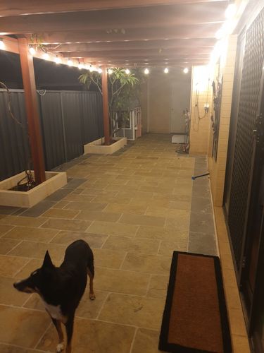

Installed some festoon lights as well to give it an special effect at night
95% complete with just the wires to add and a final tidy up with the paving.
Will add final photos once compete.

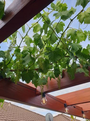

Just thought I'd post a few update pics now that the grapes have reached the top of the arbor and we recieved out first crop last summer. 100% recommend an arbor if you want the sunlight through in the winter with nice shade (and juicy grapes) in the summer. It takes a while to get the full results, but definitely worth it.

Hi @Shay,
Your gorgeous grape canopy over your arbor is awesome! Your patience and hard work have really paid off. I believe you also built some planter boxes around your posts, what have you planted in those?

Hi Katie,
Thanks for the message.
Yes, we built planter boxes around two of the three supports on the arbor. The centre one has two grapes in them - one red and one white table variety. The box on the end has a couple of pink frangipanis in it. The frangipani is great as it provides nice morning shade, with the nice bonus of the pretty flowers
