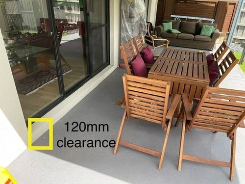

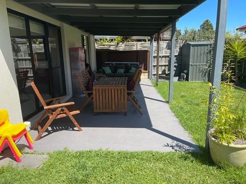

Preview of the finished resultHello Team, i plan to build a deck outside within the shed area over concrete area.

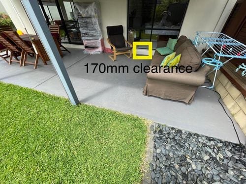

Dimensions are 8 meters x 3 meters. Ground clearance at the entrance (left side) is 120mm but on the right side window clearance is 170mm.
I want to build a deck with merbau 140mm running to parallel to house with picture frame design.

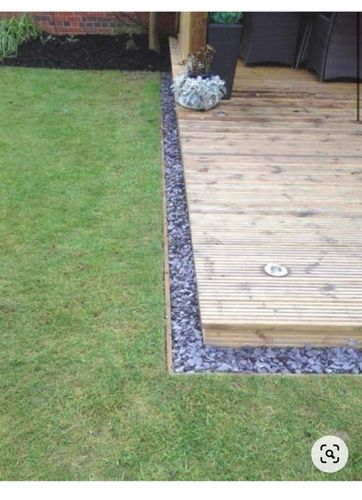

Also i want to lay pebbles at the edge of decking like this
I have read the “Building low clearance guide” and want advice on lengths required to start the project. Appreciate your guidance. Thanks
