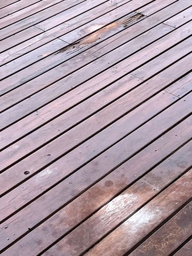

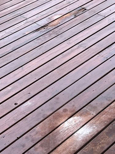

The balcony above our apartment is seeping mineral salts onto our deck below. These salts are eating into the timber deck boards and they are rotting.

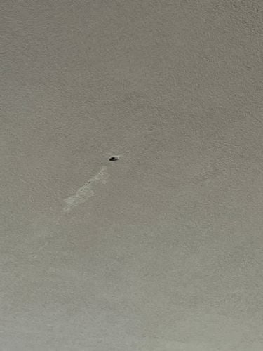

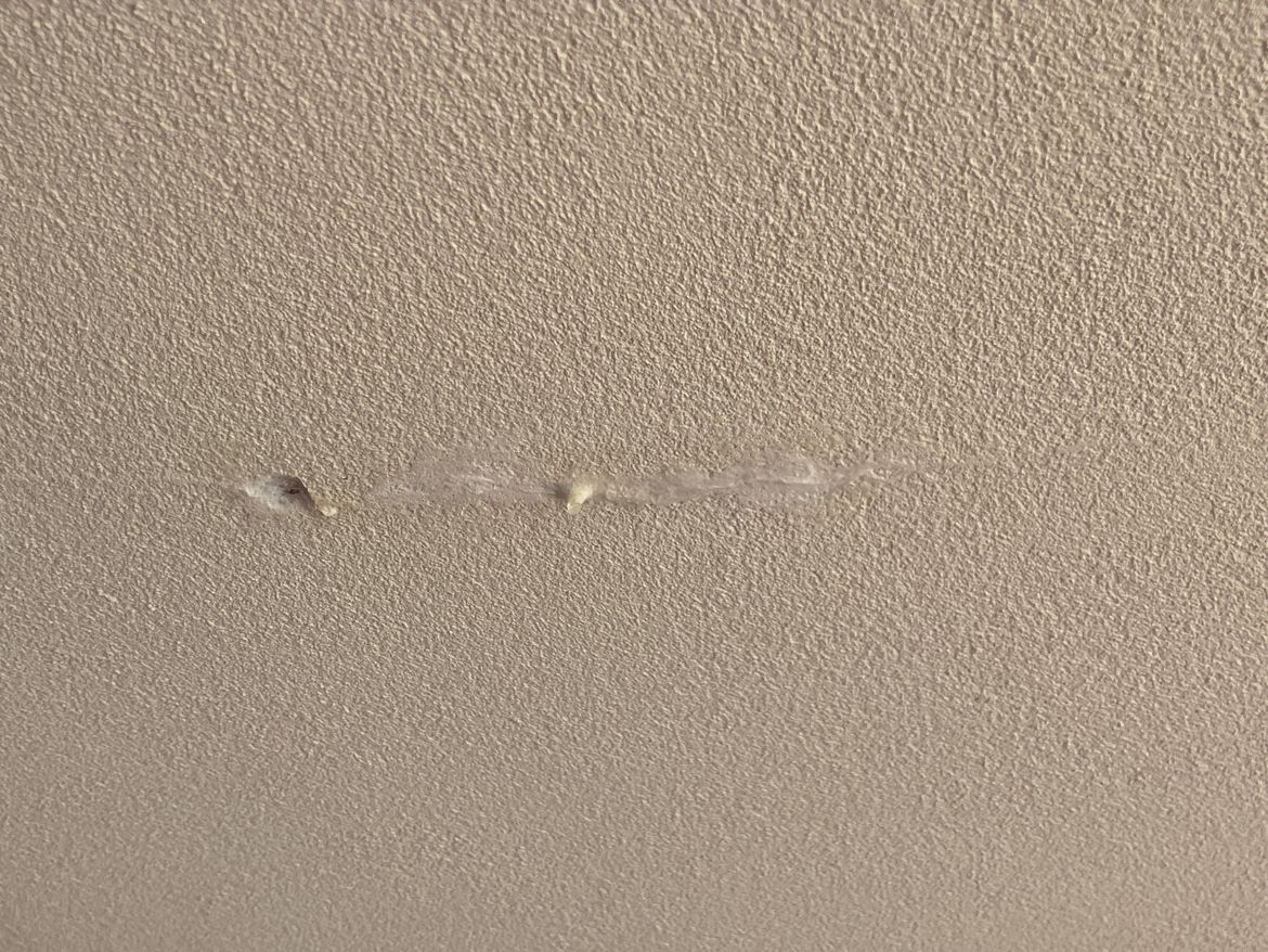

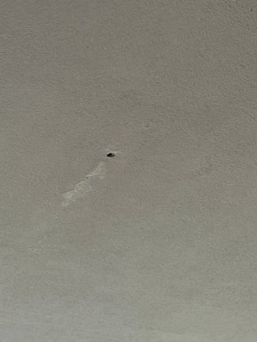

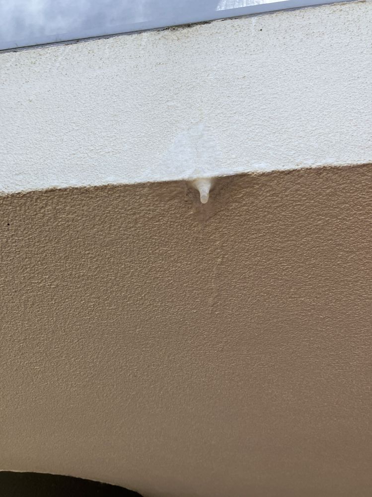

The hole in your neighbours upstairs balcony looks like a weap hole? I am not sure of the ruling about if they are acceptable or where acceptable when it was originally built. With the rotting of the deck in that one spot? It seems that it has been going on for a long length of time. How many spots across your balcony are there? Short term fix would be to have a mat/dish/potplant filled with rocks to dissapate the drip and also stop it always being wet. Long term It be looking into the ruling and also having a chat to body corporate for your complex as a first step.

We have in fact this week replaced the whole deck below, hence why this issue is concerning me. In the mean time I have placed a plastic paint drop sheet under the balcony.
There are two main weep areas, I have attached recent photos. One is on the front side of the balcony, should I also apply Crommelin Penetrating Sealer & Water Repellent to front facing side of the balcony too?
