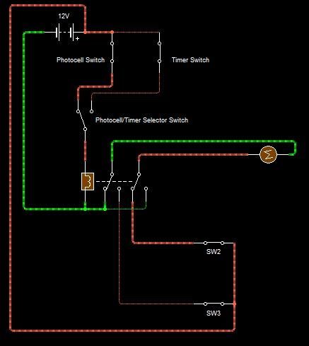

@Lpreciado There are several ways to wire a photocell into your door opener. Here is a very simplified way to do it. I reduced the Photocell down to just a switch for clarity AND because there are a few diffent Photocells out on the market, that to try and predict which one you will choose is impossible. So here it is. Let me know if you have any questions. I also added a Timer/Photocell selection switch. This gives you the option of using the Photocell, a Timer or Manual operation in the timer.
P.S. If or when you buy your photocell and/or timer, post a pic of them and if possible the scematic and I could add it to this scematic to help you wire it up.

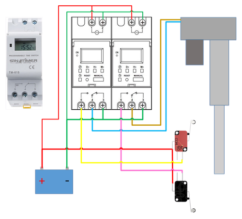

However I have since rediscovered a better way to wire this. As I was explaining, in another forum, how the door locks and windows worked in a car, it Hit me like a light bulb and turn on like a ton of bricks.
All you need is
2 Timers TM-615 or 1 Timer TM-612
1 Actuator with internal limit switches
The wiring goes like this:

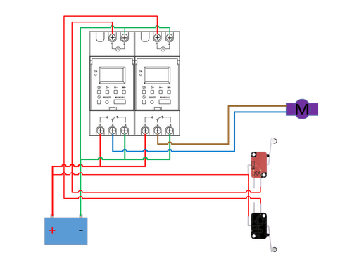

If you are going to use a 12V DC motor and not an actuator you will also need
2 Limit Switches.
