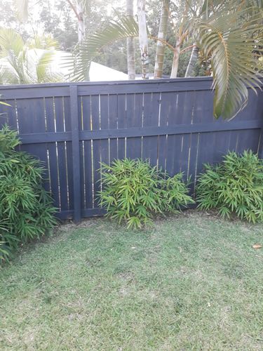

Hello I would like help regarding making my existing fence more sound proof please. Presemt ir is an existing paling fence with shrinkage that has caused gaps. My neigbours have a pool really close to fence line and would like ideas on blocking noise.

Acoustic Fence Wrap. IMO, it's the ugliest thing you can put up, but it's Black and your plants will stand out better in front of it (you can always install lattice panels over it as well). The noise reduction in those things are unreal, though they can get expensive.

Interesting topic which I haven't come across before. It looks like @Remarka6le has some experience, though. I've checked out these acoustic fence wraps, and they seem to be anything from rubber/vinyl matting to multiwall blankets. I suspect anything you place in front of the fence will reduce the noise transfer to a certain degree. We're looking to disturb the sound waves by deflecting them away so they can't pass straight through. I'd imagine these EVA 50 x 50cm Interlock Foam Mats would also do a reasonable job of deflecting/absorbing the sound. You can cut them to fit and secure them to the fence with Liquid Nails. You'll want to invest in some screening to cover over them.
I'm sure vinyl floor matting or EVA foam won't be as effective as a purpose-built blanket, though they could be a good compromise if the price of acoustic fence wrap makes them prohibitive.

A friend had a similar situation across from a noisy neigbour across the back of their property, the Fence Wrap did a good job until we were able to build a solid brick wall (which did wonders by itself), then reinstalled the fence wrap and finally planted some thick hedges to bring in some green.
Just putting hedges and plants by themselves won't provide a lot of noise reduction, but I find a combination of 60mm thick brushwood and some plant lattices do a great job dampening noise in my grand parents home.

Hello and thankyou for suggestions. what do you think about fibre cement sheeting? for noise reduction. There is a guy on here who did it?.
Also does Bunnings sell Fence wrap

Thankyou i may use fence wrap. But so ugly. Or i might build a wall something that absords sound.

Hello, i will be getting some fibre cement sheeting and getting it attached to my existing fence. I then have some bamboo sheeting that im going to cover it with to make it look nicer. I will post photos and let you know whether this sheeting has lowered the noise. Thanks for this group for the ideas.
