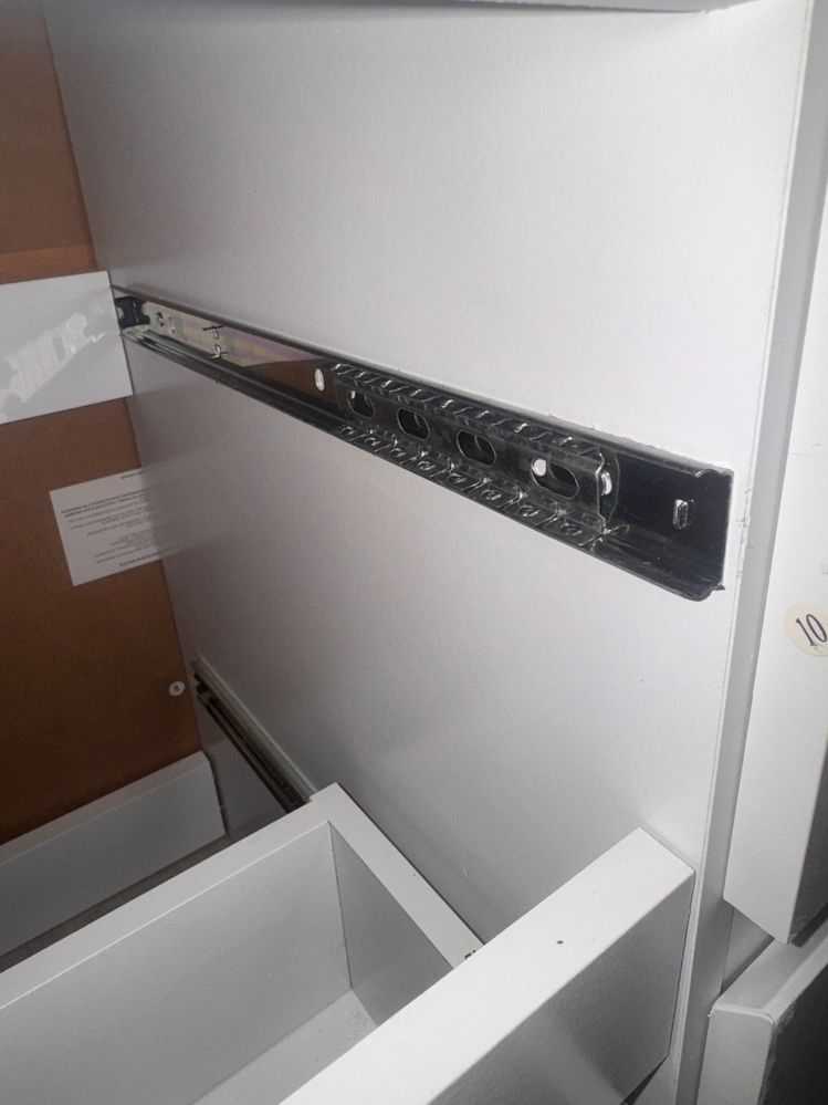

The running drawer has stuck and the drawer it is not closing in proper way

Everything I have and install it perfectly. Only last two drawer has been stuck in the runner of the drawer cannot work anymore

The key to working out why the runner is not functioning is to determine what it is getting stuck on. Sometimes there is a clip that need to be depressed to allow the track to retract. Move the sliding section back and forth and try to see what it's hitting that's stopping it from moving as it should. If it is a clip or a button, push it so the runner can by-pass it.
If this is one of our cabinets, then I'd be more than happy to contact the manufacturer for further troubleshooting.
