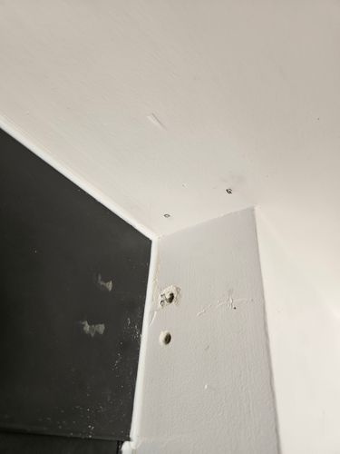

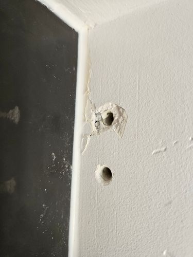

I'm trying to install some new roller blinds to our new apartment. Since it's plasterwall, I tried inserting the wall plugs that came with the kit. However it keeps getting stuck about 3/4 way, then it just gives way and bends when I tried to push harder. The wall has a bit of damage now as a result of me trying to push the plug through. The depth is definitely deep enough as I have drilled past the length of the plugs. Just wondering if I should drill the hole bigger or get stronger plugs.

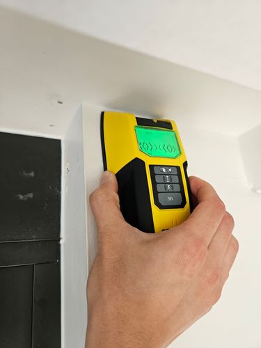

Also when I use the stud finder, it detects metal on the side. I'm guessing that's just the metal frames inside for structure but I'm not sure...

If your stud finder is indicating steel, it's probable that you have a steel stud wall. If so, I suggest using Zenith 10G x 50mm Galvanised Countersunk Head Metal Screw. These are self-tapping screws so pre-drilling the steel will not be necessary. There is no need to use a wall plug as this will anchor itself into the steel stud.
To repair the holes you've already drilled, I propose using UNi-PRO 500g Multi Purpose Interior Filler.
