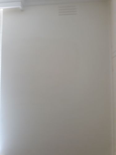

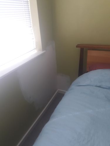

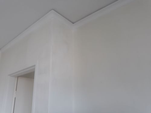

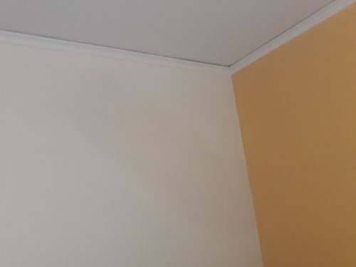

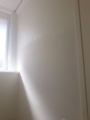

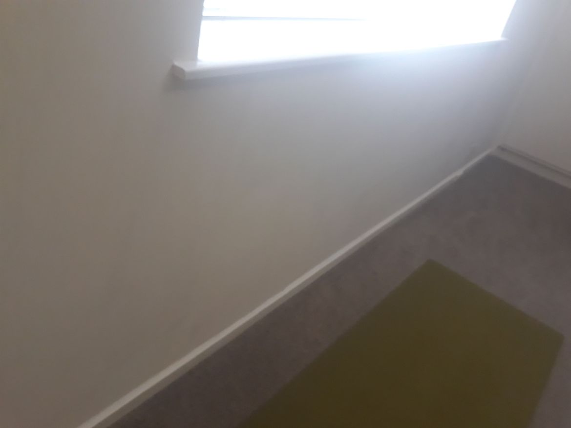

washed off undercoat. plaster drying.
connector room 2
bathroom 1
bathroom 2
bathroom 3 - darker area bigger than 1 sq m
spare 1 - see darker area left side
spare 2 - slightly darker above door to right 0.5 sq m
spare 3
spare 4
spare 5 most of lower part and 2 x 1 sq m patches either side of window

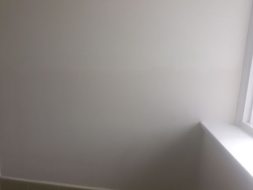

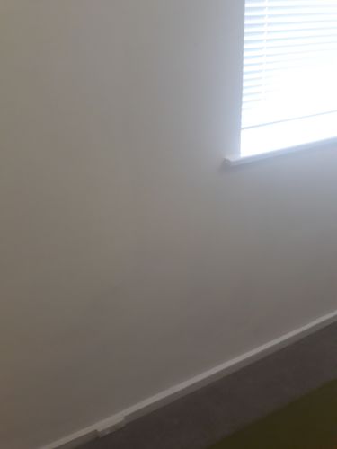

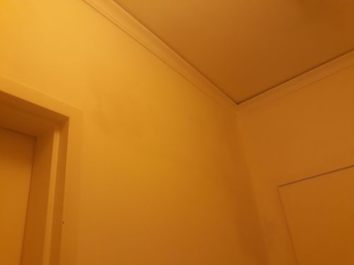

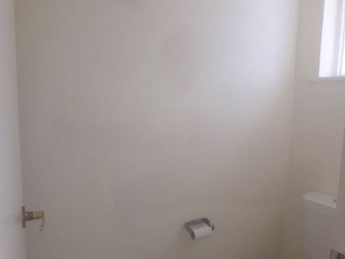

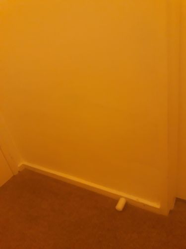

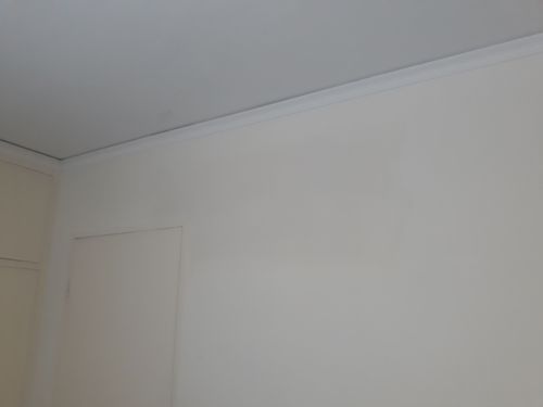

IS THERE ANY CHANCE you are able to resolve this today? Tomorrow is my only day to prep before the big Easter paint job.
Photos hard to take (poor phone cam and lighting conditions). Hope these suffice.
The cracks were fine cracks, however the plasterer chose to cover a large area around them.
Sometimes the wall was bumpy and gouged, from a bad 'bog' repair previously.
One spare room crack was fine (you couldn't fit a knife blade into it) but long, three-quarters the length of the wall and up toward ceiling, for example.
Hi @LivMitch
Thanks for posting those photos of the wall repairs. Just to be on the safe side, I suggest using the Dulux PRECISION Sealer Binder White on those repaired areas. You can clearly see that the plasterer did a thorough repair job as they covered the entire wall and not just the cracks.
