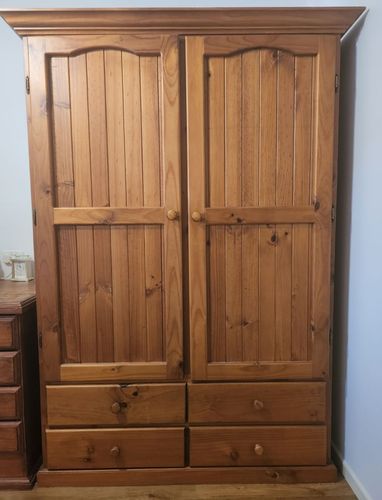

1/4Remove the drawers and doors and give everything a light sand. Cut timber trim with a mitre saw to fit just inside the perimeter of each drawer front. Attach with wood glue.

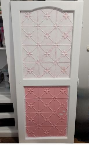

Apply two coats of undercoat to everything including the tin and then two coats of white satin paint to everything except for the tin. Paint two coats of the dark pink to the tin. Once dry, adhere to the doors with liquid nails.
Step 3

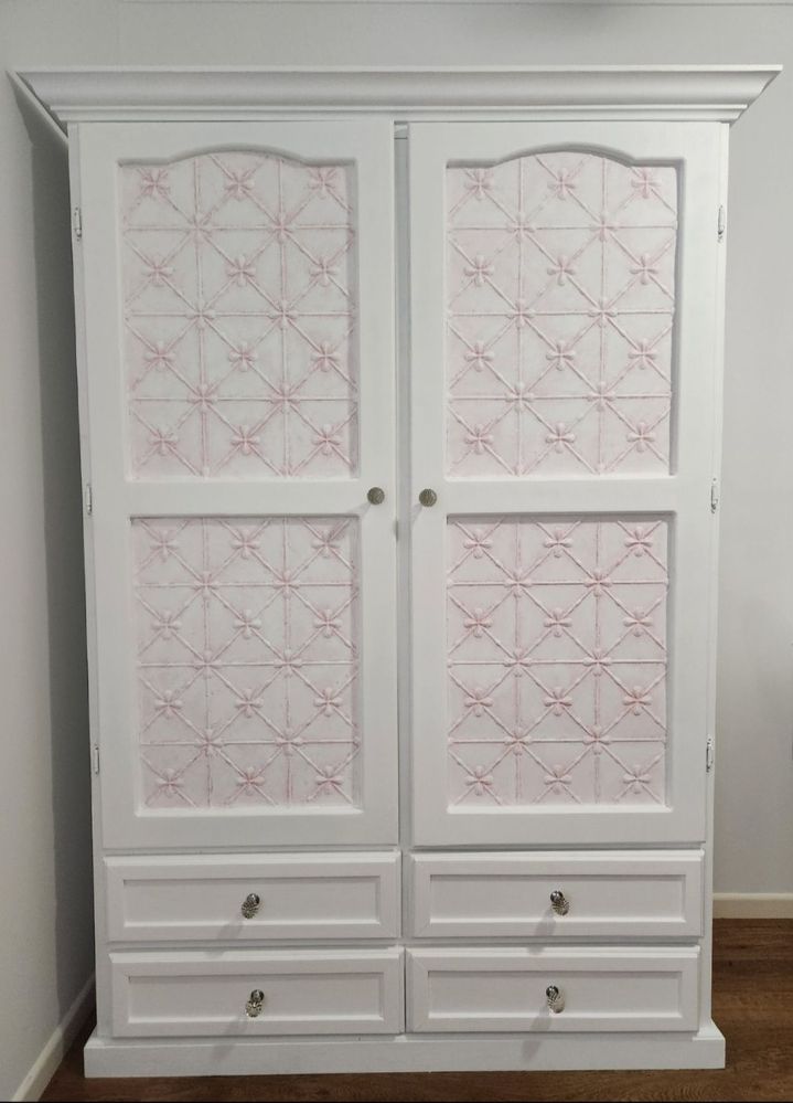

3/4 Apply beeswax to the tin with a rag to areas you want to keep pink then stipple white paint until you have the desired effect. Wipe off excess beeswax with a clean rag. Reattach the doors to the wardrobe.
Step 4
4/4Before
Attach the crystal drawer knobs

Hi @KellieN,
Thank you for sharing this wardrobe upcycling project with our community.
You've turned a dated old wardrobe into a beautiful piece that will certainly get the attention it deserves.
I'm sure you were happy once the sanding was done, it would've taken forever.
The feminine colours and crystal style hardware give it such a pretty look and the pressed tin inserts are such a unique and fabulous idea.
Congratulations on another fantastic project.
Re: Wardrobe Makeover
Thankyou, it's one of my favourite projects
