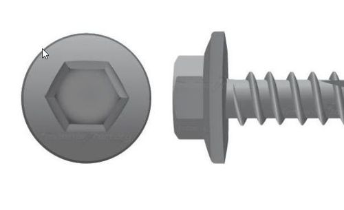

Thanks @EricL - interesting you say the bugle doesnt need washers but hex head does. The hex head screws seem to have a washer behind the head by default as attached unless I'm misguided. I'll take your advice anyway!

Hi @jasejw
Just so there's no confusion about the hex head. I've placed a picture below of the hex head screw that needs a washer. The one you've chosen is perfect as it has the washer integrated into the hex head.
