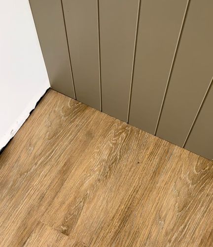

The flooring is actually a loose lay 5mm vinyl plank which made it very easy to remove.
They are my go to flooring for DIY application.
I was also able to sit the headboard on top of them and mark the cut line with a pencil.
I then cut them with my drop saw at the end and relayed them as below.
