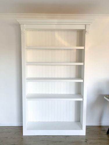

Hi all, I wanted to share this DIY project I did last year in lockdown. I love the VJ paneling so much, it was the whole reason for this upcycle.
I bought the bookshelf off Facebook marketplace for $50. I sanded it down with 120 grit sandpaper, wiped the dust away and then painted 2 coats of British Paints prep 4 in 1 white. Finally finished it off with 3 coats of leftover Dulux natural white interior paint.

Looks incredible @lieselroberts, especially with your styling.
Thanks for sharing another beautiful project with us, and I look forward to seeing more.

What a beautiful upcycled bookcase. That VJ Panel effect really stands out with the white paint. How has the paint held up? Are you still using it as a display and have you had to repair anything on it? Any updates you can provide would be much appreciated.

Thanks a lot. I definitely agree, the VJ panels really do stand out!
The paint has held up really well, thanks to the British paints prep 4 in 1 (sealer, primer, undercoat and stain blocker) which is a crucial step in painting furniture. I upcycled this bookcase last year in lockdown and have moved my decor pieces around a lot since and it paint has remained intact. I haven’t had to repair or fix anything.

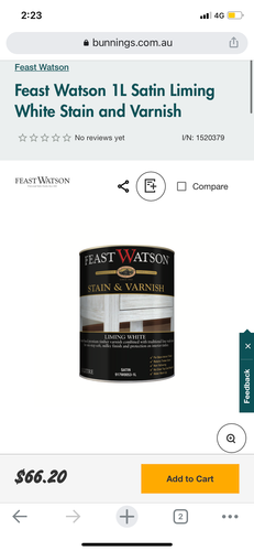

I’m looking to replicate what you’ve done with an already varnished bookcase just like yours but I wanted to paint it using some leftover liming white stain and varnish (see pictured).
Wanted to ask if there were any appropriate undercoats/primers that are clear and not too opaque because I want to have the look of the grain of the wood remain when I apply the stain and varnish?
Any recommendations would be very much appreciated! Thanks in advance 😊

The Feast Watson 250ml Liming White Satin Stain & Varnish doesn't require a primer, but you'll need to sand your varnish to a dull finish. You can then apply the product, and you'll be able to see the wood grain through it. You can read more about the surface preparation and application for liming white here.

Thanks @MitchellMc,
That will make my job a lot easier then 😊
As always appreciate the tips, hopefully it comes up well!
