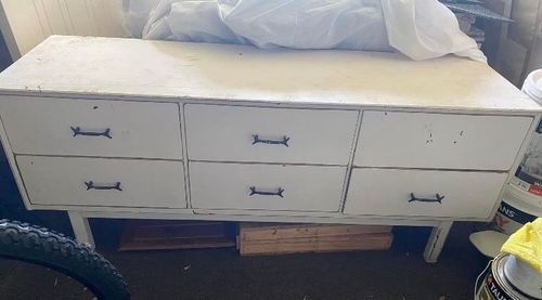

Old free drawers, bit of sanding and turned into a beautiful TV stand

1/4Remove old handles and give it a good wipe down.

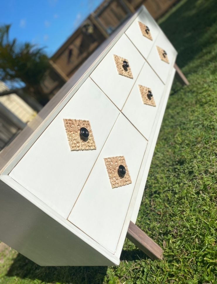

Sand the cupboard , only light sand on drawers and sides but the top I stripped back to the wood. I applied 2 layers of 123 Zinsser undercoat & 2 layers of chalk paint on the sides and drawers.
Step 3
3/4 After painting, stick on the moulds. Varnish the drawers and sides with
Carbothane varnish, 2 coats.
Step 4
4/4
The top I used Liming white stain and varnish 2 coats. Screw on the drawer knobs
