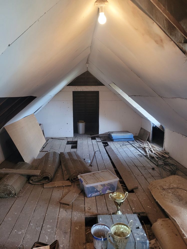

Hi everyone,
I'm looking for some easy and cheap DIY solutions for my attic space. I'm hoping to turn it into a bedroom/office area. As you can see from the images, it's a bit of a blank canvas at the moment. I'm not looking for anything too fancy or permanent, just some ideas to make it more functional, organized and comfortable.
Any suggestions would be greatly appreciated!

Hi @Jinx,
Assuming you will be reinstating the timbers that have been lifted, my first thought which ticks all the boxes is carpet tiles. They will make the space feel more functional and organised and can be laid directly over the floorboards without any glue so you can easily remove them in the future.
Alternatively, a sheet of vinyl flooring could be laid over the space with minimal effort that if not glued can simply be rolled up and removed in the future.

Afternoon @Jinx
Like @JacobZ I am asuming you will be fixing the holes in the floor?
First step afterwards would to be sort out any potential leaks as those plaster sheets like like they may have been wet from time to time..
I like @JacobZ's carpet tiles or I was thinking even a rug over the floorboards would give the place a nice feel.
Which way is access to the area? And another thought, how wide/steep is the acess? Thinking of what sized items you can bring up to the area.
Do you have power available up there other then the lights?
Where abouts is the light switch for the area?
Is that window able to be cracked open? I think there are new laws stating how far a window/skylight can be opened recently. (last year or so)
100% envious of the space :smile: I wanted to do teh same but dont have such a peaked roof as yours and also not sure if the added weight of the floorboards would be wise for my place. Do you have any bowing in the ceiling underneath?

Yes - would be fixing holes in the floor, they're created by an electrician running wires - hence desire to keep it reasonably accessible.
Plaster is gone - if you can see video i've done that already.
i like the idea of the carpet tiles, this is a farmstead house though (could get dirty) and it's also upstairs so sound dampening is useful.
Correct access is by a small ladder/opening up so not all items may fit
Power is available in the area, and lights are available - there is a switch by the entry up
The window can be opened up but a couple of skylights or something would be ideal for the space (ventilation) required too...
No present bowing; the beams and structure is alright, just some of the shingles need a bit more TLC...

Video looks good and the removal of the plaster is tidy :smile:
Love that loft look.
Since you mention its a farmstay and might be concerned about carpet tiles getting dirty. I have carpet tiles on my concrete floor in the garage. I track dirt through there all the time as Ive been working on the gabion basket and digging just outside the door. The dirt vaccums up no worries and there is no wear and tear on the carpet tiles. I picked them up as second hand ones from a carpet place. Lots of times they have replaced older tiles with new so they need to get rid of older ones :smile: Oh I paid $0.50 each or maybe a $1.00 I really cant remember as i was so excited to have a "deal" lol
With the power points, always err on the side of an extra couple when installing. Even if you think of what can go up there someone will change the layout and then your extra power points will come into play :smile:

What an awesome workspace @Jinx My vote is one of @JacobZ ideas with carpet tiles. Economical, easy to lay, durable and far more forgiving than laying Vinyl. Plus it's going to be a lot quieter and nicer on the feet.

Hi @Jinx,
Before you start with any flooring, I recommend consulting with a professional about whether the structure can support the added weight, especially if you're planning to use heavier materials. It might have been suitable for light storage, but considering your plan for an office it is important to know whether the frame beneath is suitably weight-bearing.

Thanks, yes, that's a good callout - I'll have this checked into.
